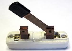

No, because you would be connecting the light directly to power instead of running it through the switch. Please look again at this diagram
and trace the flow of electricity.
A basic switch is very simple. The switch in your wall is just like the one below, just encased in a plastic box. Notice how in the open position shown the circuit is incomplete.
Image source: Wikipedia
