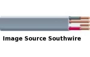

Ok, please, let me rephrase= 1 red(hot), 1 black(hot), 1 white(neutral), 1 green(grnd) conductors. All insulated.
You guys know the 6-3 uf doesnt have a bare wire. Are you guys just busting my chops on that badly stated reference to the geen ground wire. I can take it, go ahead...
Thats actual one of my biggest questions the wire types used.
For instance, the separated green bus ground, coming off the sub to the ground rods; bare or not?
Does it even matter for code? [And i think Nash, your saying its gotta be 6awg not 10awg.]
If you guys talk me out of the 6-3 uf, to go with #6 awg THWN wouldnt that cost even more. And is that the right type wire ? or was it TW
why is pulling one 4 conductor line all twined together (6-3 uf) harder then 4 separate 6 awg conductors?
Wire in UF isn't twisted together so maybe you mean mobile home cable.

The outer coating of the UF cable makes it harder to bend.

6-3 UF is some high $$ stuff. I don't understand why you would want to pay premium for a direct burial cable and then put it in conduit too. Although I am not a big UF fan, I think this is one instance where I would use the direct burial UF cable direct buried and not in conduit. You are just talking 11 feet here. That being said, conduit would be required for protection where the cable enters and emerges from the earth (at each end of the run), but the horizontal run underground would have no conduit. You are also running about 15 feet under the mobile and in my opinion that would need to be UF or individual THWN conductors in conduit. The way I see it, you can run UF the entire distance and not need a splice box at all.

You also need to answer the question if you are really talking a bout UF cable because you described it as twisted and it isn't. It is flat with a gray outer sheath. This is UF cable:

Yes ray, i know just what it is, It's flat a little less then 1-1/4 inchs in width (i've had it in my hands)
I used the word twined... maybe banded, infused, flat lined, hermetically encased, would have been better. lol....

My wire pricing quoted:
6-3 UF - $2.68 ft. x 60 = $160.8
#6 THWN - $0.65 ft x 240= $156
So both are going to cost me almost the same.
It seems to me after speaking with a local electrical shop (he knew some code standards for this area)
I can skip the uf in conduit under the home. And just fasten it to the joist.
Thats within code here.
So Im faced with how hard could it be to pull 6-3 UF 17 with 2 elbows one way and 13 with 2 elbows on the other side. Why ask this to myself?
Because you folks have now brought to my attention the different style casing and the not as bendable UF problem I didnt foresee coming. But at the same time its going to cost more with all pvc and pull time with the more pliable #6awg THWN.
Looking at this UF originally, I figured the 1-1/4 pvc would make the pull easier because there was a lot of space left in the pvc to work with. Maybe some lube on the wire will work better? Like maybe dish soap. [what do you think ray; dish soap?]

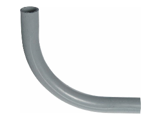

Question I'm stumped.
Point of entry was only feasible on one wall.
Load center on different wall.
(L SHAPED path: 2.5' left to corner, then 2' more on that wall, then about 1.5' up into box)
My issue seems to be no possible way to get 1-1/4" sch 40 around
a 90 degree corner. Not to mention the 6-3 UF inside it.
So now that I've come up thru the bottom wall plate with 6-3 uf wire in pvc, and I am technically inside a wall about 2' up from the floor plate [well it will be a wall once I wire the rest of the walls, & install insulation and then paneling]. Does the wire have to stay in conduit? I ask this because it doesn't seem possible to do that? I'm also looking at drilling 1-3/4" holes thru wall studs and that doesn't seem to be a great idea for the stability of the wall structure. With the corner turn; there seems no way I'm going to be able to get a 90 degree elbow thru the stud unless the outside wall sheathing wasn't there. So I'm stumped. Now once I get to the break box wall I can go back into pvc and enter the bottom of box correctly.
Any ideas/suggestions guys?

The UF can be run in the wall without conduit. You will need a bushing or fitting for a smooth exit from the conduit.
Not if it's inside the wall. As pcboss said,
Do you have enough cable to reach the subpanel without splicing?
Is the can for your subpanel not made to allow the feed to enter through the back, directly from the wall?

oh yeah, I got plenty of cable to reach box with about 5' left over.
No splicing required. I measured this out about 3 times before I
bought that wire. (with wigle room as noted)
Box has the usual ports: back, side, top, bottom.
If its true, that 6-3 UF is that wide, 1.25" PVC might be to narrow. You might have to derate, or go bigger.

You should not have buried any of the L fittings. They need to remain accessible like a junction box.
Cables have a bend radius restriction so the insulation does not get damaged.

sir, I don't think we're on the same page here. forget L shape "fiting" for a second.
lets speak about what do you put at the end of the PVC that is down
24" into the ground with 6-3 UF inside it.
that is now gonna go horizonal under ground.

You use a sweep ell.
But of course you don't need to put UF in conduit once it is in the ground.

U know I was going to use sweeps (i call those elbows) on the two up starts but then i figured why bother... seemed like over kill.
Knew nothing of radius limits. never even heard that one before.
whelp, I guess I'm back to playing in the dirt/mud once more.
