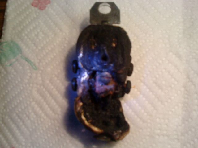

Mysteriously Burnt Outlet
I encountered a burned out electrical outlet today that has me scratchng my head. It's a standard 3 prong single-gang outlet. It was totally burnt. Black smoke marks ran up the drywall about 10". This outlet is a single wire outlet, only one 14/2 conductor w/ground was attached. It's about 18" from the floor. According to the renter, nothing was plugged into the outlet. The renter said they went out for a while, and when they came back, they discovered the damage. The breaker was tripped. The was no evidence of bugs, critters, centipedes, etc. in the outlet box. No chaffed wires. They DO have a dog.
I gotta ask the pros here; is it possible; have you ever seen a case where a dog raises his leg and pees on an outlet and causes it to burn out?
What else could cause this? Thanks.
Actually that would be single cable not wire. My guess would be they plugged a portable electric heater into it. The dog would be low on my list. Were the wires back stabbed? Is the breaker box a Zinsco or Federal Pacific (FPE)?

By burnt, I mean totally fried.
The 14/2 w/ground cable was indeed, "back-stabbed" to the outlet. Only one cable ran to it. The Renter swears nothing was plugged into it. If the dog tinkled on it, and had dry paws on carpet, he would be above ground, so he might not get shocked, but his stream could cause a short???
Is there anything else that could cause this? Again, no bugs, spiders, insects of any kind in the junction box. Single cable termination. Never seen anything like this. ????
Note: Only the black (hot) wire showed evidence of over-heating, ie: the insulation was crispy. The white (neutural) and ground were OK. (normal) Haunted house? What gives?

I'm still betting on electric heater. I haven't seen it that bad but I have seen burnt wires and white receptacles turned brown that crumble when you touch them. Back stab would accentuate the problem. What make of breaker box? FPE amd Zinsco have been known to not trip under overload.

I'd go with ray.....a heavy draw device like a heater. It looks like someone took a blowtorch to it....some kind of actual flame....weird.

An electric heater was my original thought, too. Again, the renter swears nothing was plugged in. They have central heat and air. No need for a heater in the living room, it's not even cold here yet. Not sure of the type breaker box, but the breaker HAD tripped. Can dog pee short out an outlet and make it burn? If not,what? Never saw anything like this.

But the breaker may have tripped long after it should have. I would replace the breaker as a precaution. It is a 15 amp breaker isn't it?

With kindest regards, I beg to ask what can cause an outlet to burn to a crisp when there's nothing plugged into it? It is a 20 amp double breaker. It DID trip. It did it's job. I'm not messing with that. I was only hoping to find the CAUSE of the trip and the fried outlet. I know, it sounds wierd to me too.

First of all the 20 amp breaker is too large for the 14-2 cable, thus the late tripping. Being a double breaker lends us to believe it could be a Multi Wire Branch Circuit as well. In NC, I doubt you have MWBC's, so it is probably miswired to a circuit it shouldn't be wired to.
If you believe your renters as to their mysterious arrival and this burning having taken place with nothing plugged in so be it. There aren't many bridges left to sell out there. It wouldn't matter if the dog was standing in rubber boots, if he peed on the receptacle it could have caused a short between the current carrying conductor and the neutral. He would have felt it.

I would strongly suggest you get an electrician out now to change the breaker. If it is truly a 20 amp because it certainly shouldn't be. I suspect what you are calling a double breaker is really a tandem breaker and that isn't bad but if the wire is truly #14 you are very lucky you didn't have worse damage. Not raised yet is the possibility the cable in the wall may have been damaged.
There is a way for a receptacle to overheat but only if there are two cables and something down stream was plugged in. If your sure only one cable in the box then that is not the reason but you do need to check all receptacles on that circuit for damage. Finally you need to move all wires on all receptacles to the screws if back stabbed.

if it wasnt a heater it could have been a window air conditoner if it was in the living room (maybe they wanted to heat/cool one room rather than the whole house)
those Infrared heaters sold last few years that "save you hundreds on heating" are just as dangerous as any other glorfied heater and dont save anything because simply a Watt is a Watt is a Watt
or even a vaccum cleaner if the backstab connection was poor enough to cause arching.

Looking at the picture, I would have to bet that something was in fact plugged into the bottom receptacle. That's where the majority of the heat damage is. If it were toward the back, then it could have been a loose connection... maybe. But you can't create heat or an arc without some type of connection between hot and neutral/ground.
Not that I would try it, but I seriously doubt any water (dog or otherwise) would cause an issue like that. Without submerging it, I would find it difficult to believe that a stream could cause a short. But... of course, stranger things have happened.
With that much damage, I would splurge and have an electrician come out and check the circuit. Something had to cause it, and you definitely don't want it happening again...

  • 14 gauge wire "protected" by a 20 amp breaker.
  • Overheating over the years as the breaker failed to open when the wire was overloaded.
  • A multiwire branch circuit, as suggested by the "20 amp double breaker," with very unbalanced loads.
  • A space heater.
  • A window air conditioner.
  • Physical damage to the receptacle -
to name a few, most of which have already been suggested.
You'd better mess with that, as quickly and thoroughly as possible. If you really had a 20A breaker "protecting" a circuit wired with 14-2/G cable, then that breaker did not do the job it was designed to do. It did a job beyond its design, by protecting a smaller wire, with a lower ampacity, than it was designed for. You were lucky, this time. We'll never know why that happened but donating alms in gratitude seems indicated.

I cut the burnt outlet out, cut the wires back to where the insulation had not burned, used a utility knife to carefully scrape off any discoloration and expose shiny copper all around all 3 wires, hooked the ends and used the screw terminals on a brand new 15a outlet. I voiced my concerns to the landlord about the possibility of the renter plugging something in that he should not have and mentioned the breaker rating/cable gauge mismatch.
The takeaway is the burnt outlet has been replaced safely to the best of my knowledge, the landlord has been informed of the situaton, and let's hope the renter has become wiser about whatever it is he plugged into that outlet, regardless if he admits it or not.

I will call the landlord and re-advise him and underscore the importance of having the tandem breaker replaced, so that the branch circuit that had 14/2 cable and the burnt outlet is rated 15a. I have no idea what's on the other side of the tandem breaker, I did not open the panel, I have no idea what the wire gauge is going to the breaker; the renter had a bunch of boxes and stuff in the utility space, and he seemed paranoid and acted like he didn't want anybody around. I will advise the landlord to call a licenced electrician to correct the matter.
