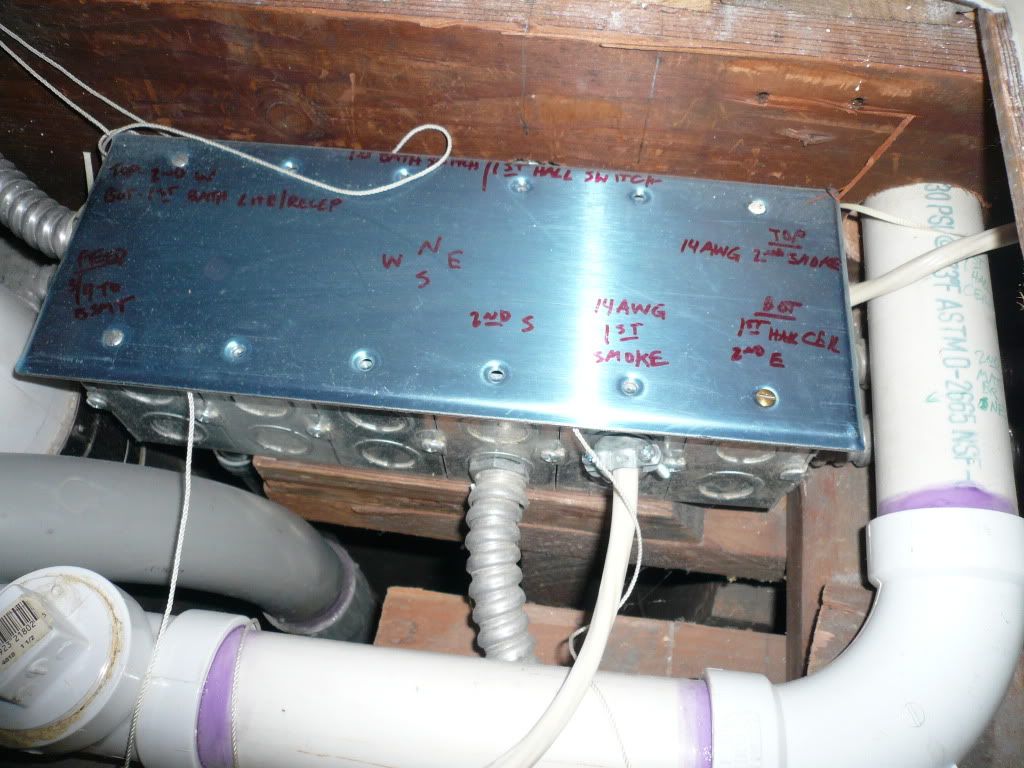

Six ganged one-gang concrete boxes. I needed the capacity in a narrow spot.
Are you saying it's not code compliant? I also have a couple of j-boxes behind manufactured trap doors in walls. I could have done that for the floor, too, but figured why go to the expense for something where aesthetics is not a concern? The hole in the floor is unmistakeably outlined in silver aluminum, and as I said, it's a lift-out panel.
I did show it to my licensed electrical contractor before the RI inspection, and he didn't have a problem with it.

JOC, what did you use to cover your 6 concrete boxes ganged together?
I think this plate is from Leviton. I did check with the supply house in advance to make sure I could get a blank, but they had to order it from some far-off warehouse or maybe directly from Leviton. The plate cost me something like $25.

Very nice. If those are pull strings coming out under the cover, I would roll them up inside the box, and slip a bit of padding between the 14-2 cable and the PVC pipe on the right, to protect against mechanical wear over time.
