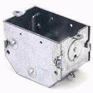

Old 10-19-12, 02:39 PM
ray2047's Avatar
Join Date: Mar 2006
Posts: 32,643
Is this the type of box you have.
The red (also hot) is...
With a multimeter measure the voltage between the black and red. What is it?
