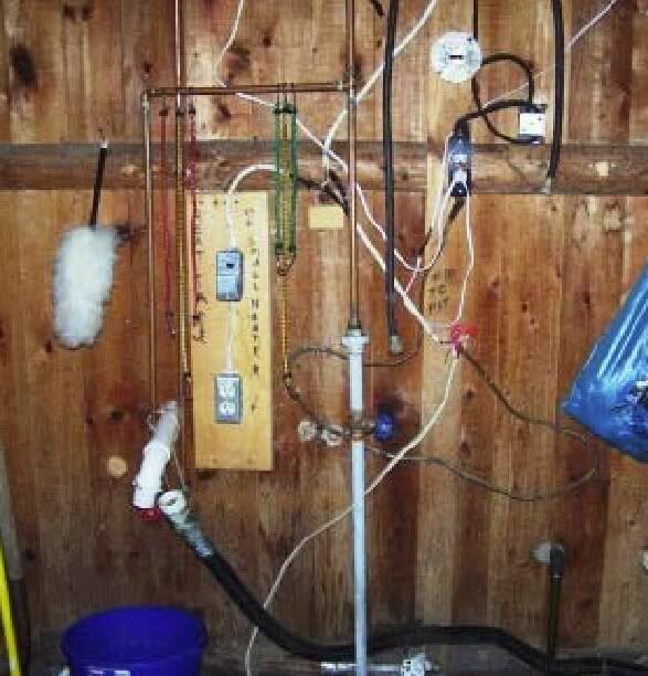

I feel your pain blargendarg. My house was wired (and plumbed) by an amateur but it looks like he knew the basics so the wires are straight and are secured. My 1st and 2nd cottages were wired by by blind retards on psychotic drugs. Zig-zagging Romex, all twisted, taped splices not even in a box, sometimes several spices on the same run, wrong gauges, loose screws...I could go on & on. Dig this:
That should make you feel a little better about your project!
