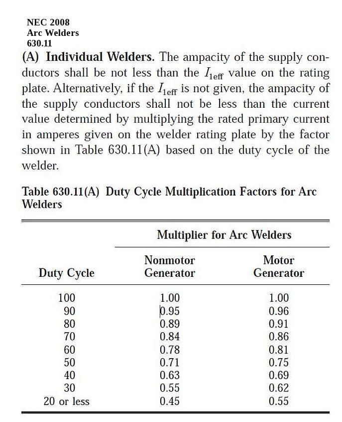

harbor frieght 110amp mig welder. 25amp breaker min I want to use 30a breaker. In my super small town the hardware store doesnt have anything bigger then 12g. And for the price like 1.50 a foot im scared to think what 8g would be.

If it is this welder: 170 Amp MIG/Flux Wire Welder - 22 volts @ 110 amps then it says 20 amp is the info. Run it on #12 with a 20 amp breaker. The worst this that will happen is the breaker will trip. Little fire danger. Be sure to take breaks, it only has a duty cycle of 20%.

IF you run a dedicated circuit for the welder different rules in the NEC apply. These rules are based in the duty cycle of the welding machine and allow a much larger circuit breaker than would normally be used.
So if your duty cycle is 20% that is 20ampsX.45=9amps so you are well with in the rating for #12.

You only need #12. Didn't you read Furd's post and my follow up?
