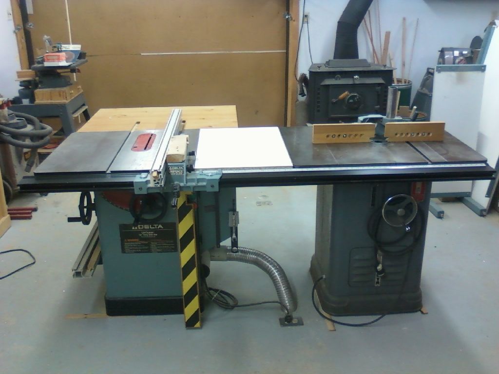

A 6-inch panel raiser spinning at 9000 RPM is a scary thing and I just want a way to shut it off easily, and prevent re-starts. A toggle switch under the top isn't much good in a panic.
For my tablesaw on the left I added the long paddle to the starter box so I can kick it off from any position I'm likely to be in--and even with both hands feeding a large sheet of plywood through. I want to do the same thing to the shaper on the right.
I was looking to do this as cheap as possible because my ultimate goal is to replace the motor with a 3-Phase one and control it with a VFD so I have adjustable speed, slow start, speed & current limits, etc, etc. If I (ever) do that all I will then need is Start/Stop push buttons.

Machine Electrics
I'll try to address all the comments in one post. It should be a help to future Googlers
Originally Posted by chandler
My Delta (similar to yours) has such a switch already incorporated in it. What are you switching it with, presently?? As a matter of fact, the "ON" button is in a shroud and the "OFF" button is in free air making it really easy to hit with my knee (sometimes accidentally) and turn it off.
Many new "industrial size" machines today come standard with mag starters for their safety and ability to sense an approaching motor overload better than a simple circuit breaker inside the motor. Keeps the mfrs. lawyers & accountants happy. Safety wasn't a priority in 1952 so mine has an ordinary 1/2" long toggle switch. Can you imagine an owner's manual today telling the owner to stick a piece of sandpaper in their running motor to deglaze the commutator? Mine does.
