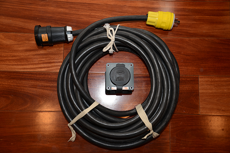

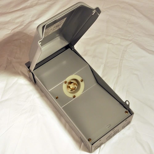

When I was shopping for inlets, the best one I found was a Midwest unit. In Use rated....I knew it was big, but when I got it,the thing was a monster.
So I did more homework and ended up with a Hubbell system. That is going to be literally almost flush to the wall. Wet weather in use rated.
Cord is made. Just waiting for springtime to do the fish the wire out and pop a hole in the wall...

That Hubbell system looks like a shore power cable for a boat!
Old 01-21-13, 08:55 PM
PJmax's Avatar
Join Date: Oct 2012
Location: Northern NJ - USA
Posts: 46,232
No Justin....it's for a land yacht

Join Date: Jul 2009
Location: NYC
Posts: 302
this was the midwest beast of a inlet
Old 01-21-13, 09:57 PM
PJmax's Avatar
Join Date: Oct 2012
Posts: 46,232
Yup.....I've installed quite a few of those.
