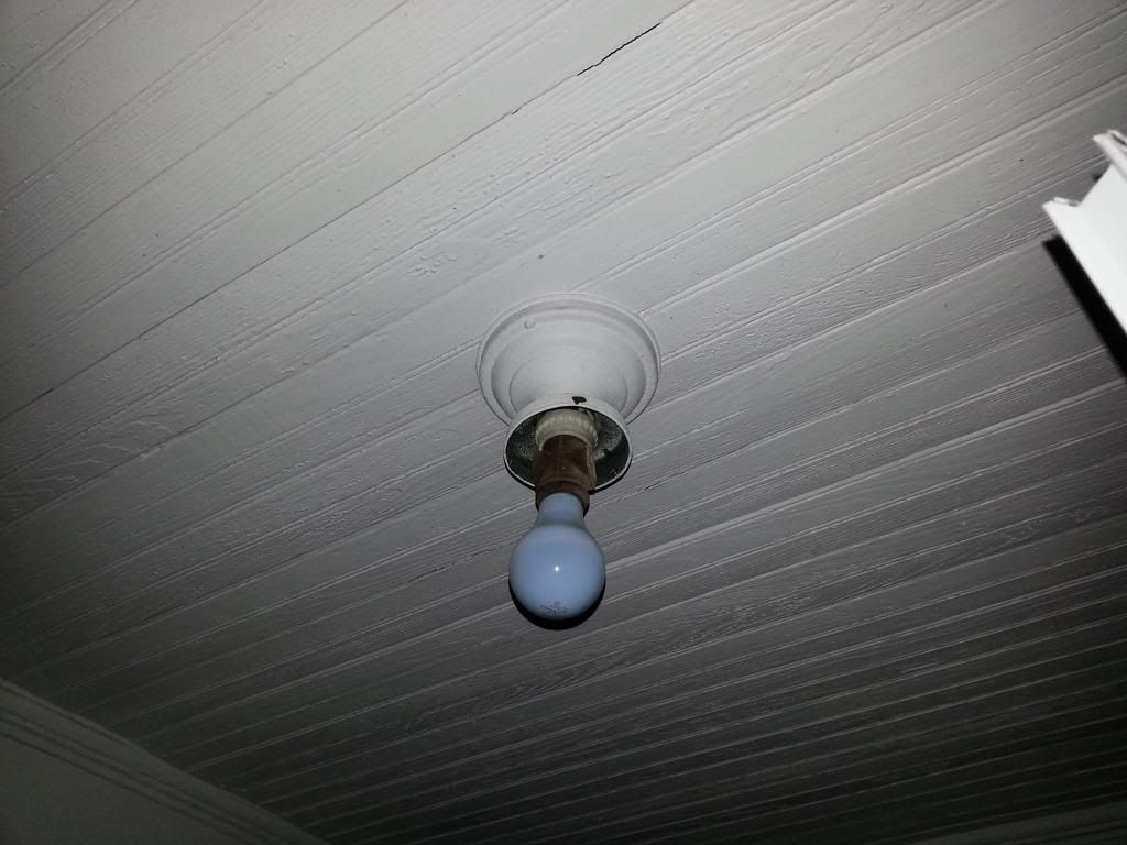

Anyway, this is the porch light:
The problem is that the hall way light works with the lutron switch, so I've pretty much closed the upstairs switch. But the porch light does not -_-. If you look at the picture, it's actually a bulb socket thing and it has a plugin for christmas lights or what have you. I'm not sure if these things come with different wiring or not, I'm totally new to this.

One thing to always remember is that there is an odd or dark colored screw on a three way switch. This is the common switching terminal of the switch.
It looks like that lone wire coming out goes to the porch light. With your meter....you should check the wires on that switch, find the one that becomes live with the hall lights and connect the lone wire to that terminal.
That light on the front porch is just an old style ceramic socket with a screw in "insta-outlet" adapter. Remove that adapter as your lutron switch will not handle an excessive load plugged into that fixture.
