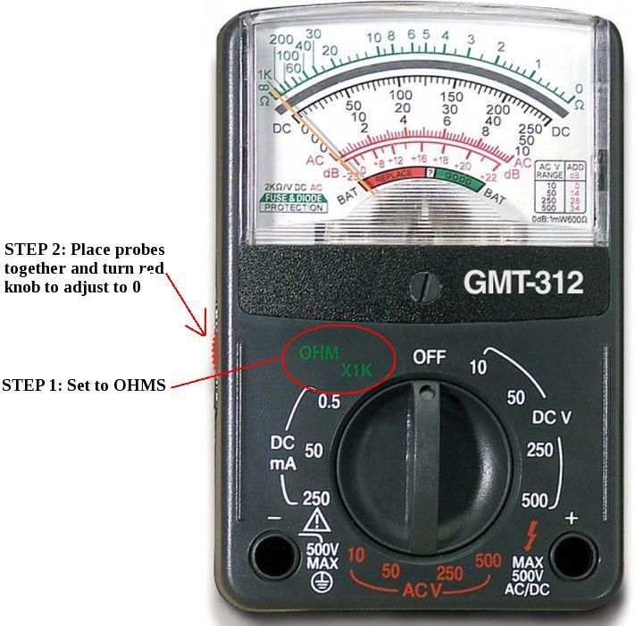

Can you give me the model number of your multimeter so I can taylor my istructions to your meter.

Hi Ray this is a GB gardner Bender multimeter GMT 312 It is analog.

On your meter the green scale at the top of the meter is ohms used for continuity checks. Be sure the breaker is off.

Yes that is my multimeter. How do I set the knob to check things.. where do I want to put it say to check the voltage.. or to check continuity? Do I need to touch the wire with both prongs?
To check voltage the power will need to be on...but to check continuity it will need to be off correct?
for what purpose do I need, or when do I need to check voltage.. or continuity?

For continuity you turn the knob to the green ohm section. To check AC voltage you set it to the red 250v mark for measuring 120 volts. If you were measuring for 240 volts you would set it to 500 volts. Mid scale will give the most accurate reading so you always choose a voltage setting where the expected reading will be mid scale. You would look at the scale that ends in 250 if the meter is set for 250. When measuring resistance (green) and AC (red) it doesn't matter which probe goes where.

I only used One cable at a time..ok...strike all of that.. I didn't have it set to the green Ohm section... do I leave the red dial on the side at 0??

As stated in the image touch the two probes together and adjust the needle to 0 using the red dial. It compensates for changes in the battery used for continuity and resistance testing. You do have a battery in it don't you? Not needed for voltage but is needed for resistance and continuity testing.

ok, with the meter set to Ohm.. I tried both wires coming from those two cables with the switch attached to each of the four cables in the box... nothing happened...no response when switch was on or off..
