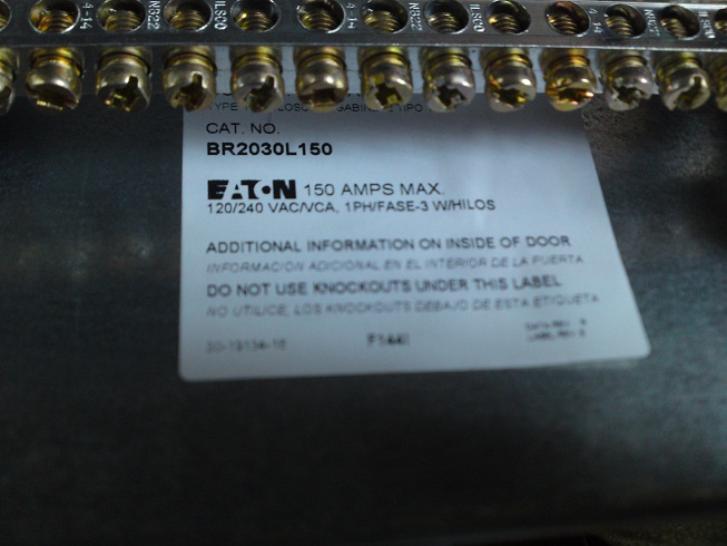

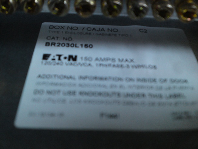

I am installing a sub-panel breaker box that appears to be main lug, however I wish to use a main breaker rather than have a breaker at the main box.
Is there a kit I can use to enable me to use a main breaker?
Here are some photos for illustration purposes.
I could really use some help verifying my knowledge on these parts, so I colored them.
Purple: This should be the bar I will use for the ground, correct? :
Red: This Should be the bar used for my Neutral wire, correct?
Yellow: What is this little things purpose, is it to ground the box to the main ground steak that I will have driven into the dirt?
Green: This is a solid aluminum bar that physically connects the neutral and ground bars, why? Is that the way it should be when my box is fired up and live? Is this normal and safe?
Thank you very much.

Here are your options.....One, the reason you have the bar in the green is that this is a split neutral assembly...not a ground bar and neutral. Companies started using these several years back for ease of installtion. You would need to buy a ground bar from a Cutler Hammer distributor. We sell GE panels and I know some of the guys remove the pc in the middle and use one for ground but that panel is designed that way...yours does not appear so as the bar runs in the back rather than the front...that panel is not convertable to a main 150 amp. They have convertible ones but this is not. If you want a 100 or 125 amp main you can buy a Br2100 or BR2125 breaker, order a BRHDK anchor kit to make the breaker code complaint (has to be held in with a screw) and mount both in tha panel......Hope this helps. Call around your area to the local electrical distributorsand see if any are Cutler Hammer distributors...........

I had to rush my first response so I apologize. This might help...
BR Load Centers for Service Entrances
The green screw is the bonding screw for the neutral, which is on both sides.....
Just to clarify, convertible means going from main lug to main breaker. What the "kit" does is give you the ablity to put a smaller series breaker, up to 125 amps in and "back feed it" thereby making it a main but they don't make any kit to make it a 150 amp panel. A convertable panel would have such a kit to install at the top and also the cover would have an opening for a larger frame breaker.
When you go to the website click on the documentaion tab and then open the pdf file "retail solutions catalogue". It has quite a few pages but you can find your panel and parts there......
If you need more than 125 amps I have no idea what to do.

No, I do not need more than 125 amps, I just "need" a main breaker(for ease) and would also like to know this.....when I get another bar for the grounds, where exactly should I mount it and how? Thank you.
Also, why are the two neutral bars connected? Why was one of the bars "changed" from its use as a ground bar to a neutral bar, what is the purpose? Why did people need one neutral bar "several years ago" but now I need two of them?
This has got me tied in a loop...I can't figure why I need two of the same things??

Having the neutral on both sides just makes it easier...how are you using this box? Feeding out of another panel to it? If so then buy a ground bar for it. The kit I refered to simply holds down a plug in 2 pole breaker. I have not used one of these but it consists of a plastic pc and a screw. The directions with it should spell it out better but bascially there are notches that allow you to simply put the 2 pole breaker in (snap it in) and then mount the plastic pc and screw in it to hold it to the panel. The ground bar will come with screws in it and you match them up with the holes in the side of the panel. Your panel should take a particular ground bar, which you can find on the file I showed you or simply tell the counter man what you have and they should be able to find it.

Welcome to the forums!
The circuit breaker you install in your main panel to protect the wires that feed your subpanel will determine the size of the connecting conductors and the maximum load your subpanel will supply. That breaker is the MOPD - the main overcurrent protection device - for the subpanel. Any "main" breaker in the subpanel is only there to be a service disconnect.
If you want a main breaker in the subpanel so that you can kill the power to the hot buses when you want to do some work in it, you can buy any panel with any size main in it that you want, so long as the breaker is as large as or larger than the feed breaker in your main panel. The MOPD in your main panel can be a 125A 240V breaker and the disconnecting breaker in the subpanel can be a 200A, for example. The same thing goes for any "main" breaker you install. Just buy one that's big enough and install it in whatever way is needed to make it code-compatible, including the anchor kit that Jim suggested.
In a subpanel, the grounds must be bonded together and to the enclosure. That almost always requires that a separate ground bar be purchased, installed and bonded. The neutrals in the subpanel must be connected together and isolated from the enclosure. If the neutral bars installed in your panel are not bonded to the enclosure unless and until a bonding screw is installed, then you may be able to use those as they are.
The grounds and neutrals are not connected in a sub panel because it could cause the ground to carry voltage/current between the sub panel and the main panel. This is never supposed to happen except during a fault.
