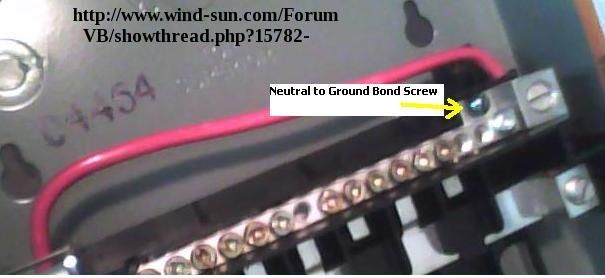

The problem is because of the existence of TWO neutral-to-equipment bonds; one in the generator and one in the Service panel. How to alleviate this condition will await confirmation that you are indeed using a legitimate means of connection.

Just for a test, open (turn off) the circuit breaker in the service (main) panel feeding the sub-panel and then disconnect the incoming neutral lead (from the service panel) in the sub-panel and then try the generator. If it works okay then the second neutral-ground bond in the service panel is the problem.
The only legitimate way to alleviate this problem is to install a three-pole transfer switch between the incoming feeder from the service panel and switch the neutral along with the "hot" conductors between the service panel and the generator. The interlock will NOT work.

I think your right. A 60A would probably due. In the case of 800 dollars for a 100A I think it will have to do. But I may not need it because of what was found yesterday. I removed the neutral in the sub panel from the main. I then removed the ground in the main that feeds the sub panal. I found that there is continuity between that disconnected ground and the neutral buss in the sub panal. With the service neutral removed that should not happen right?

As I told Furd there is a problem with my ground and neutral connections. I removed the neutral from the service panal in the sub panal. So all three (two hots and neutral) were detatched from the sub and the generator gfci still tripped. With all the breakers off in the sub panal I have continuity between the ground buss and neutral buss. I'm looking for that conection now. I hope that when it's found and fixed that a three pole disconnect won't be needed. With the neutral disconnected the gfci stayed closed. Is there an easy way to find this ground problem?

As long as you have the neutral-equipment ground bond and the GFCI circuit breaker in the generator you will need the neutral switching transfer switch. I do not advocate any changes to the generator.
