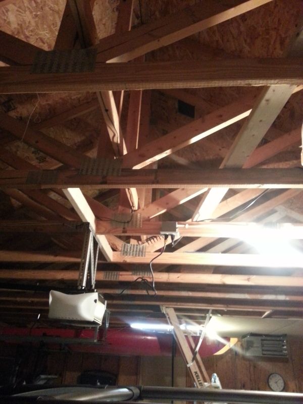

Running a thermostat wire the length of my garage. I ideally would like to run the bell wire over the rafters really close to the wall to avoid a trip hazard in the attic. However, there are many wires (110v) for the outlets which take the same path the entire way to the heater. I've been told your not supposed to run low voltage wires next to high voltage wires do to interference. However, I'm likely thinking of low voltage wires for telephones. Should I be concerned or does it make no difference what so ever.

It would be best to keep the low voltage wiring separated from the high voltage wires by at least six inches if possible to eliminate any interference.

The interference issue is more for communication cables (Coax, Phone, cat5 data) then thermostats. I have never had any issues with line voltage wires near thermostat wires. (or doorbell for that matter.)

I normally ONLY see that as an issue with communication wires. Are the wires for a thermostat? If so, what kind?

Just a cheaper Honeywell 3 wires to turn the heat on or engage only the fan.
I'll likely run the wire along the underside of a board that runs the center span of the garage. I ran the bell wire to the garage door opener that way already.

You should have no problems doing it that way.
