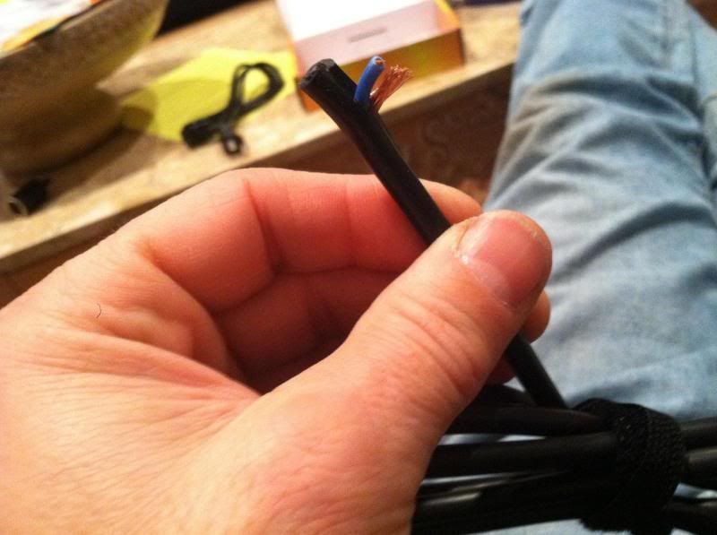

I ended up going with this AC to DC converter: Bestek 7 Amp AC to 12V DC Power Supply Adapter Charger TV Car Cigarette Socket | eBay
When I cut the cord leading up to the cigarette jack I found a blue and copper wire (as seen in the photo below). Are they substitutes for the normal red and black wires? Thanks again

The uninsulated wire is usually the ground or the negative in those adapters but I would get a meter just to be sure
The colored wire blue in this case SHOULD be the positive
but as I said get a meter to be 100% sure
No problem.
In your case the polarity isn't critical. Try it one way.....the worst that can happen is the lift goes the wrong direction. The switch you are connecting to is a polarity reversing switch.
