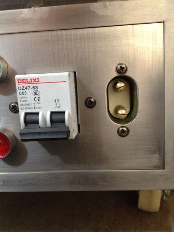

Ok I bought a dry ice fog machine that came with the attached plug in.
I believe it's 220v because the user manual says it is 4000w. The way this thing works is it boils water and then you add dry ice to it close the lid and it shoots out a very thick fog out of the bottom of it. It's pretty cool.
Anyways I want to check the thing out but need to wire it up first.

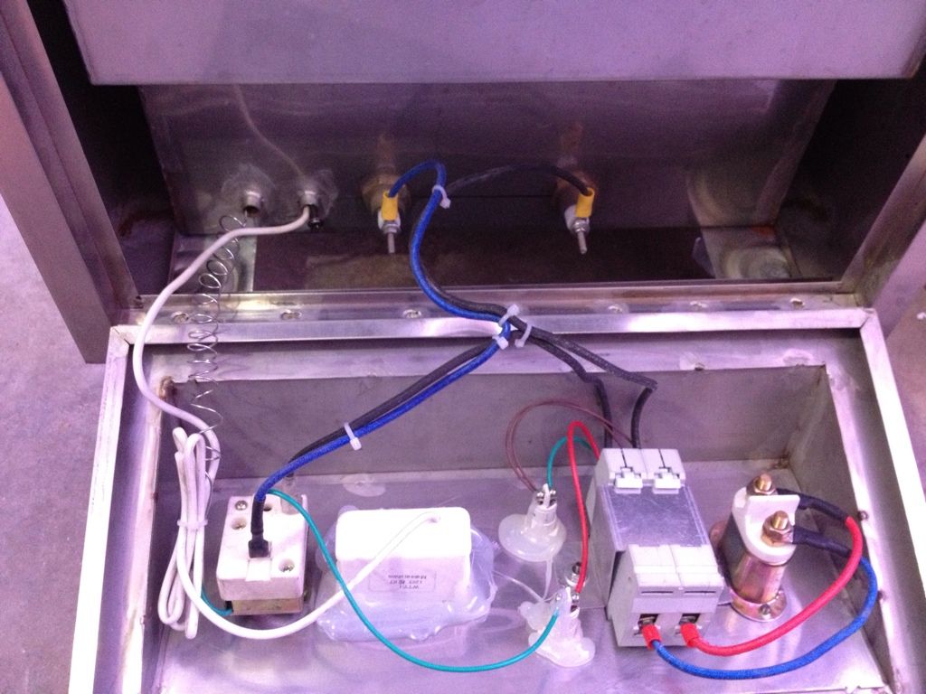

Here is a picture of the inside
I want to add a ground wire to the frame, It's all stainless steel. I was thinking of removing the plug that is on it and just wiring a 5' 10-3 cord that terminates in a 220v 20a 3 prong plug? Does that sound like a good idea? I have a 3prong recepticle to plug it into.
What is the make and model? Did it come with a cord with a female end that matches that inlet?
You'd better find out for sure before you hook it up. BTW, you don't have 220V power available. You have a single-phase 120/240V electrical service. Do you have a link to the manual?
Grounding the frame isn't a bad idea, but I don't understand how the cord would work. Would you use SJ cord to make one?
Most of us have 3-slot receptacles all through our houses. None of them is wired to supply 240V. So what are you planning to plug this machine into?

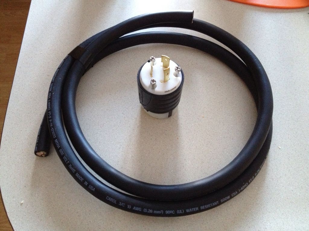

I'm going to add a SOOW cable like this one and this specific plug,
I don't want to use that because there is no ground.
I do have a 220v outlet in my house that is a NEMA 10-30.
My real question is about adding the ground. I'm guessing that since this is a heater, that it operates very much like a baseboard hearter, which has 2 hots, and a ground and the ground is connected right to the chassis if the baseboard heater, that's what i want to do here. Does anyone see any problem with that? I'm also not familiar with that breaker that is on there does anyone know if that should be a problem?

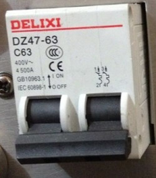

It has what appears to be a 2 pole GFCI circuit breaker* that is labeled 400 volts so we can assume less then 480 volts and probably more then 120 volts. Can you at least give us the Ebay link.
*DZ47-63 comes up as a non US market GFCI circuit breaker in search.

Heres a picture of the entire insides, it's a very simple design.
The entire thing is stainless so yeah i think i got a pretty good deal on all the steel.

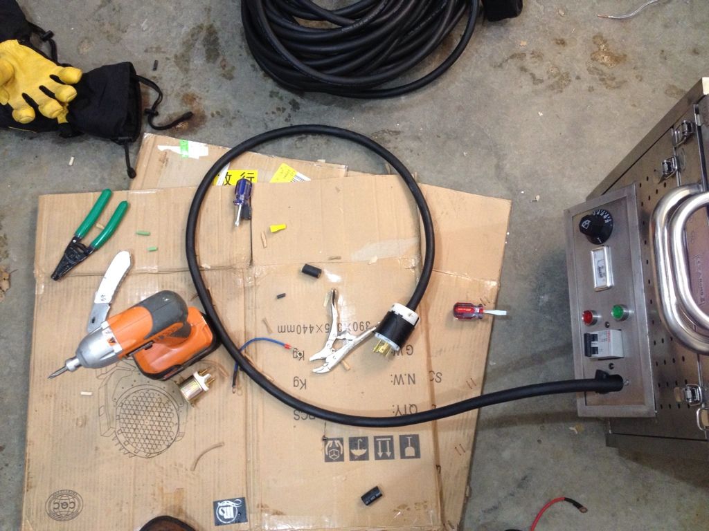

Heres how i wired it. This is for testing only i'll have to find something to work as a ring around the cord right where it enters the box. I'll let you know how the test go. I'll prob test it out tonight. The heater design of this looks a lot like a small deep fryer.

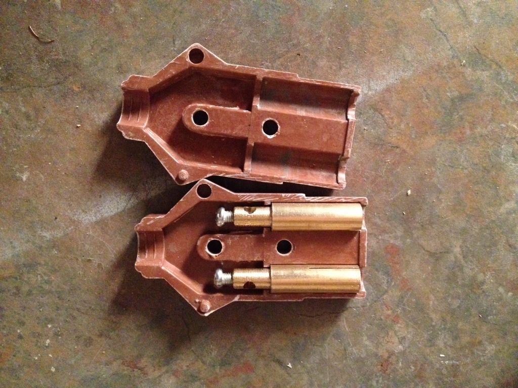

You could use a connector that would normally be used for non metallic cable.

I got so i wired it with a 3 prong range plug to test it out at home. I can't seem to buy Dry ICE anywhere close right now because it's cold here. I might be able to get some next week and test out the dry ice feature then.
When i plugged it in i could hear it starting to bubble very quickly right away. I would say it had the water up to 80c in about 5 min. Which is awesome. I need to make one slight change in the way the hood is designed but it worked!!
