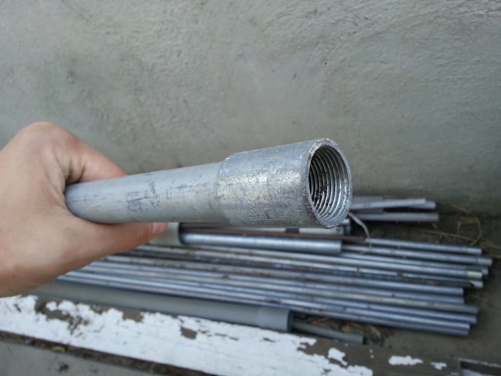

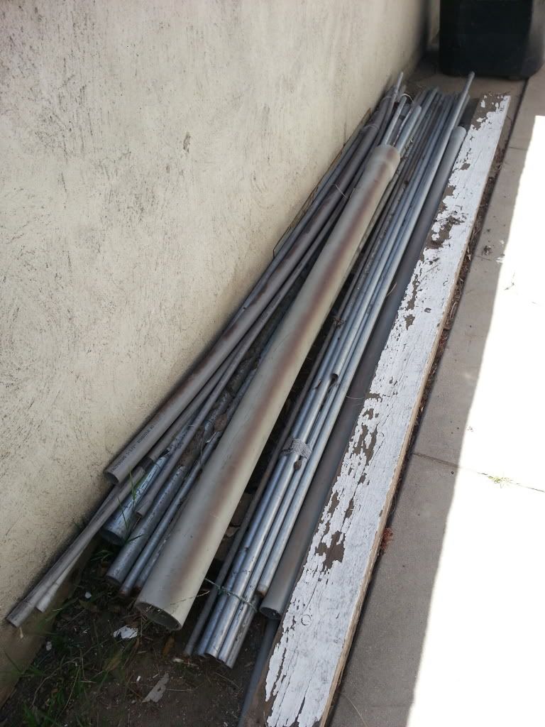

This is what the setup looked like before I tore things out.

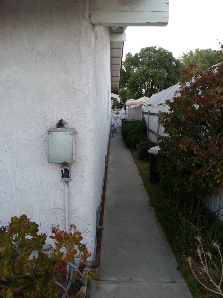

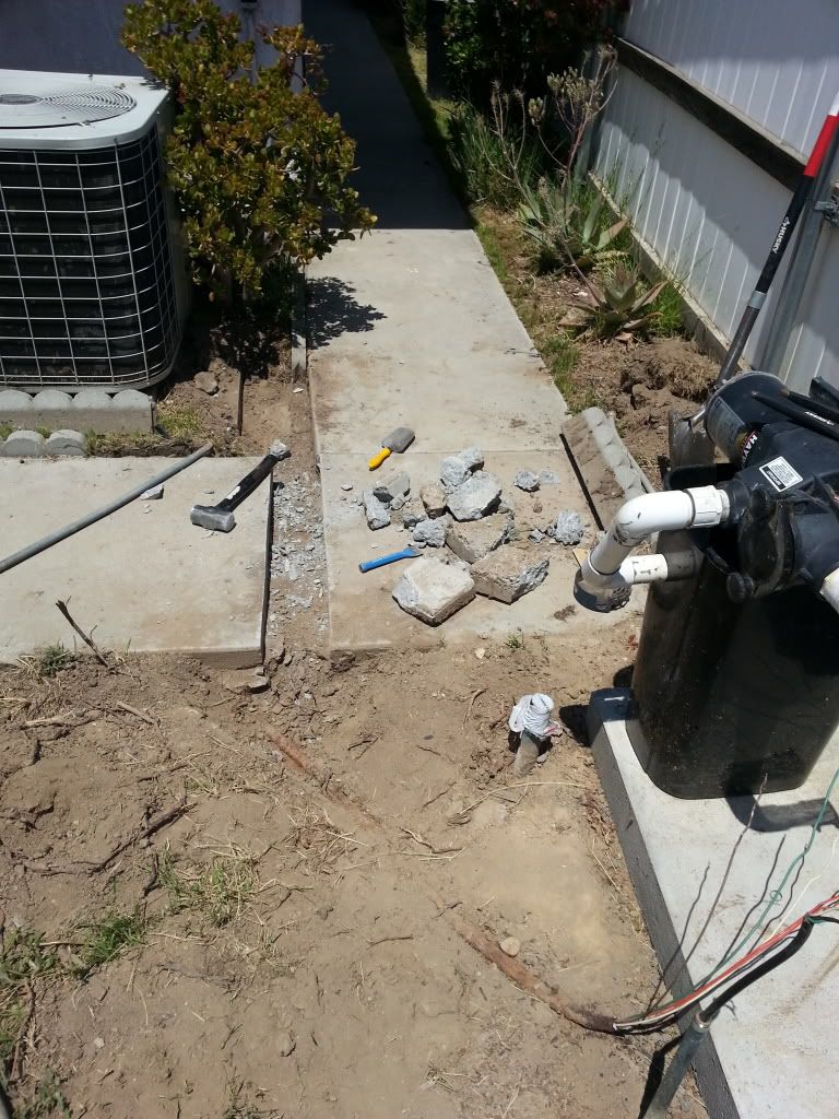

This one is after I tore stuff out. The conduit on the left brings power to the site. If you zoom in you can see the wires I described above - 2 orange, one brown, one white and one green. The conduit on the left looks like copper and it goes to the pool light.
If we turn to the left, you can see the rusty conduit go underground and towards the house in the direction of the plant, past the A/C unit.
This picture is in the same direction, but a little closer. You can see the conduit go up the wall and to an electrical box. The main circuit breaker panel is on this wall, almost all the way at the end, where you can see the gate.

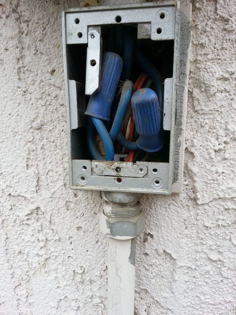

Here's a close-up of that electrical box on the wall.

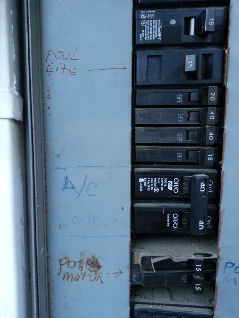

And finally, here is the circuit breaker panel. Second breaker from the top is the "Pool Lite" breaker. I don't know why it's double the height of the other breakers right below it. The first breaker from the bottom is the 240V to the pump.
It is a full height, or standard, breaker. The ones immediately below it are half-height, or tandem, breakers.

The two conduits coming out of the ground in the second photo are about 7' away from the pool. My main concern is a wet person touching the pool timer and getting shocked. I guess GFCI would provide protection for that scenario.

I see. So a 240V 15A GFCI breaker would look sort of like the A/C breaker above?

I understand that the green wire is ground, I just thought that I couldn't re-use ground wire from one circuit to ground a different circuit. Am I wrong about that?
Yep. A 120V circuit is one hot and one neutral. A 240V circuit is two hots. Equipment grounding conductors are pulled with those but are not part of any given circuit because they should only carry potential in the event of a fault.
Originally Posted by Glennsparky
6. GFCI(and you cannot mix GFCI and nonGFCI wires in the same conduit.)
So feed both loads from GFCI breakers.
Yep, just with the addition of the test button. But the same size and shape.

Well, I had the first guy come in. Said he's been an electrician for 20 years before I was born. C10 (electrician) license checks out.
He didn't know anything about bonding. He said that I'm the second person that asked him about it. He said that the pool is its own system and is "grounded" separately.
He said that one problem is that the pool light is not connected through GFCI and he'd put in a GFCI box. I asked him if he meant a GFCI receptacle and he said "no, it's just a box". I haven't seen GFCI boxes, only receptacles. Do such boxes exist? I've only seen receptacles and corded inline ones.
He said that the pump is not required to be on a GFCI breaker. He said that GFCI would trip too often.
And he said he'd also put in a switch to the pump so that I can turn off the pump and keep the timer running. I said that I can just turn the whole thing at the breaker. How often am I going to "work on the pump"? If I ever need to, I'll just set the time.
When I asked if permit is required, he said that a permit is required even for changing a light bulb (joke) because they want to collect money.
He said that the trench has to be dug 16" deep and asked who's digging. I said I'd do it. Then he quoted me $690. I said I'll think about it (meaning big fat NO). He didn't tell me anything that I can't do myself.

Sorry Alex, that's disappointing. That guy sounds like a bad fit. But let me play devil's advocate and ramble a little bit. It may help you with the next guy.
Ok, that's crazy.
Many electricians will use the word ground instead of bond. It's wrong, but it's common usage. Call it an extra ground and homeowners just accept it. Otherwise homeowners ask tricky questions like, "what's the difference between a bond and a ground?"
A bond wire does not go in pipe and is exposed when the inspector shows up. So even the laziest inspector will catch bond issues. Which teaches electricians to get it right, even if they don't know what it is.
It looks just like a GFCI receptacle except it has no slots or holes for plugs.
That's possible. Each jurisdiction amends the code in small ways or doesn't pass it into law for years. You may still be on the '08 code or earlier. And I was mistaken before, pumps on GFCI didn't come in until the '11 code.
That's unlikely for a modern GFCI. If a new GFCI trips it's more likely you need to fix your equipment.
That switch may be necessary. The disconnect must be "in sight of" the equipment.(680.12) If I were working on the pump or the heater could I see the breaker? Is the breaker within 50 feet of the equipment? A no to either question means you need another disconnect, like a switch.
That's true, but no excuse for not getting a permit.
He said that the trench has to be dug 16" deep ...
That's a weird depth, no matter how you slice it. Either your jurisdiction is kookoo or he is.
Measurements in table 300.5 are given ttop(to top of pipe). In general, for PVC it's 18" ttop. Lay PVC in a ~20" trench, measure 18" from grade ttop. You're good. Rigid is 6" ttop. 4" of concrete over a pipe is golden. 16"? Doesn't match up with anything I see.
