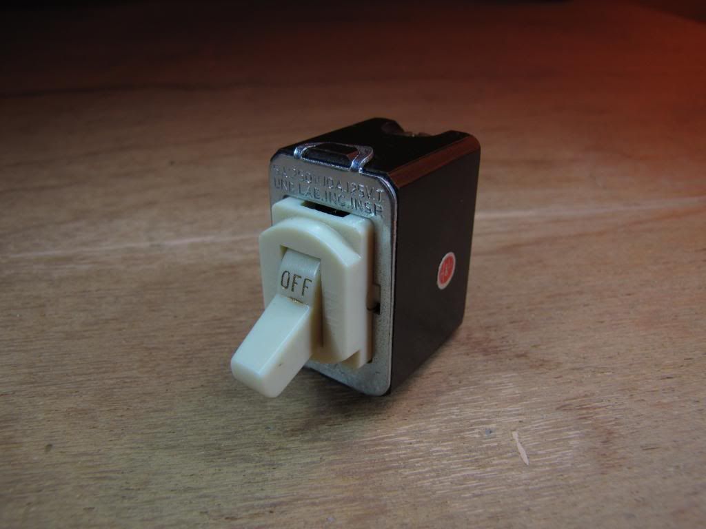

Cleaned a bit of the basement today and unearthed a small stash of 'lectricians goodies. Everything is familiar to me, excepting 5 toggles that I found.
One is pictured below...

Those mount in snap-in plates for a custom setup. Look up despard devices.

[ATTACH=CONFIG]13814[/ATTACH]
(Image courtesy of Kyle Design.)
You insert the switch in the yoke and then using a small screwdriver bend the tab (shown on the right in this image) to lock the device in place.
