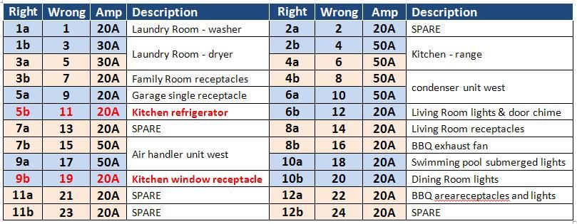

While trouble shooting something I took the electrical panel door down and noticed a few things that makes you go "hmmm..."
Now I am not an electrician but even I can see this may be an issue, or two, or even three.
First, I saw two conduits where multiple hot wires and 1 neutral wire go into. One of them was a red, a black, a blue and two white. So there are two circuits sharing one neutral wire. There is another 3/4" conduits with 4 hot and 2 neutral wires going in, but I haven't traced that line yet to see what goes on there.
Back to the conduit with 4 wires, 1 red, 1 black, 1 blue, 2 white. All #12 solid copper wires. The red is on circuit 11, the black on circuit 19.
I read that shared neutral lines must be on opposite legs off a double pole breaker, so that they can trip together, so that one is a no no right there, correct?
So question 1, if I do want to implement this shared neutral configuration, can I move the breaker for circuit 9 to where circuit 19 is, and then put in a double pole breaker to connect the formerly circuit 19 wire and circuit 11 wire to the new 9 and 11 breaker position MEANWHILE still keeping the sticker labels "19" on the wire and breakers? I am asking because I do not want to relabel the stickers on the circuits. Many of the junction boxes have sticker labels on the wire, and if I swap the locations 11 and 19, there is no guarantee I will be able to hunt every label down and relabel them all, I am not worried about labor, I am worried about me missing one label and caused confusion and potential hazard for later. Of course, having a breaker in slot 11 labeled "19" is also confusing, but not as much.
Next, I traced the conduit to the kitchen area. The blue wire and it's neutral goes somewhere else. I found out the red goes to the refrigerator and the other black goes to a bunch of kitchen outlets, the neutral is spliced. At some point in time, someone had replaced a few of the kitchen outlets (not all) with GFCI outlets.
So question #2, I read that a shared neutral line would cause GFCI outlets not work properly, is this correct? I did a search and the answers seem to be mixed, some said yes some said no.
I looked at the conduit which is a 1/2", it's solid wires and I don't think I can pull another white through it, the run is about 80 feet long. So my question #3 is, if I cannot run another white conductor through this, can I run more neutral wire via a separate conduit to arrive at the same junction box? Easier yet, can I run a 12-2 romex cable from the panel to the junction box, but only use the white conductor portion of it?
Thanks for reading this long post, appreciate your input and suggestions.

No not commercial system, residential. My home, existing wiring, I was doing something unrelated. I just noticed the wiring going up to the conduit out of the panel and they didn't "pair up". No one is doing anything to them I simply traced it to see what's going on.
The blue (and it's neutral) is a totally different circuit. It goes to an outdoor BBQ exhaust fan. It only shared the same conduit.
I have two panels in my home each one serves a different wing.

Very hard to tell from your picture, but it looks like you have 120/240V single-phase service. If so, then circuits 11 and 19 can't share a neutral. They're both on the same leg of the split-leg service.
Can you recheck that?
Again, it's hard to tell from your picture, but it looks like you have a lot of half-height breakers. If so, Are you numbering each of them with its own number or are you numbering them by full breaker space with a letter for each half?
Just noting, though, that 5b and 9b are also on the same leg. Hmmmm....

Sorry, I meant to follow up on this but got side tracked.
Let me summarize what I found.
First, to answer Nashkat1, yes, all the breakers are half height breakers, so whoever labeled them previously as 1, 2, 3, 4, 5, 6 are actually 1A, 2A, 1B, 2B, 3A, 4A respectively.
The circuits who shared a neutral wire, labeled as 11 and 19 are actually 5B and 9B.
So one question is, is labeling this way a problem? I guess I need to stick with this since on the other end, the junction boxes, receptacles, the conductors are labeled the same way.
To answer ray2047, I used a voltmeter and measured between circuit 11 (5B) and 19 (9B) and the reading is 0v.
If I measures between 11 (5B) and 13 (7A) the reading is 240v.
Also between 11 (5B) and 12 (6B) is 0v.
This means 1,3 are on opposite legs of 5,7 and so on.
Now, circuit 13 is now a 20A spare. If I move 19 (9B) to 13 (7A) then I will be all set and a properly made shared neutral configuration right?

Whatever else is going on in your panel, circuits 5 and 9 are NOT sharing a neutral. The breakers wouldn't hold for a second. Please re-check the numbering, using a whole number for each full-height (1") space.
I have checked and double checked. It is 5B and 9B. It's functioning. 5B is a 20A breaker for a refrigerator. 9B is also a 20A breaker for a bunch of receptacles in the kitchen but they are hardly ever used.
If you want to leave it in the state of confusion it's in now, it's your house. If it were mine, I would have renumbered (and relettered) every circuit so that I (and anyone else working on it) would know which leg something was fed from.
Understand. It's going to be a tough decision. As you can see I have two panels, they were labeled panel "A" and "B" respectively. Between both panels I have over 60 circuits. Now all labeled incorrectly according to the convention. However, if a circuit in panel B is labeled "21", then where the conduit leads to that wire is labeled "B21" in that box. If that wire is spliced or runs to another box everywhere a wire of this circuit appear they labeled "B21". I would have to open up ALL the junction boxes, receptacles, light fixtures...and relabel every wire in them. That would be a lot of work plus if I make a mistake in the labeling...which is easy, for example "B21" right now mean panel B, circuit 21 but the correct designation is really the second panel, circuit 11A. My head hurts...

I understand. The only suggestion I have at the moment is that you might start by drawing out two panel schedules for each panel - just on paper. You could then compare them to see if you feel that the clarity gained by making the change would be worth the effort. You could also use them, if you decided to change the labeling, as references.
Their decision to label the conductors at each junction and load is unusual in a residential system, but common in commercial work. If that was done accurately within their convention, then following the reference sheets should make the re-marking easier. The A and B designations for the two panels is also conventional. I would keep those, I think, but use lower-case for each half of a full breaker space. B21, for example, would become B11b, at least on the panel schedule. I don't know if that helps, but I thought it might.
I have checked and double checked. It is 5B and 9B. It's functioning. 5B is a 20A breaker for...
Hmmmm...
In the standard NEMA designation system, the breaker spaces on the left side of a panel are odd-numbered, from 1 through 29, say, in a 30-space panel. The spaces on the right are even-numbered, 2 through 30.
The two feed buses feed alternating rows of breakers, thusly:
1 - 2 A
3 - 4 B
5 - 6 A
7 - 8 B
9 - 10 A
11 - 12 B ....etc.
Following that convention, space 5 and space 9 are both connected to leg A and should not be able to share a neutral.
In addition to checking whether the spaces are numbered this way, you can do this test: Set your multimeter to a range of 250 or more VAC - the lowest range it has that is greater than 240. Test the voltage between the wire terminals on 5b and 9b. If you see ~240V they are on different legs. If you see~0v they are on the same leg.

Thanks Nashkat1, I think we are in agreement that 5b and 9b *SHOULD NOT* share a neutral...but as it stands they *DO*. That's why I am concerned and wanted to remedy it. 9b has two receptacles inside the pantry which are rarely if ever used. We have another two circuits from another conduit supply receptacles at the counter space which we plug in microwave, coffee maker etc...perhaps it has worked for many years because the only load on those two circuits was the fridge? There is 0V between 5b and 9b, while there is 240v between 5b and 7a, that's expected right?
I made a label of my PANEL "A". left side of the panel is the first three column, right side is the next three column. The 1st and 4th columns are labeled "Right" or the NEMA designation you spoke of. The 2nd and 5th columns are my current system as labeled. To their right is a brief description.
I shaded those breakers on the same leg with the same color.
5b (my 11) and 9b (my 19) are on the same leg.
7a (my 13) is a spare breaker. I can disconnect the conductor from 9b and reconnect it to 7a, I only need to relabel this one conductor to that refrigerator outlet, it is a single run to there and terminated there. Two labels one on each end. That's the simplest I think. Agreed?
What did you get when you tested for voltage across the two terminals? What makes you think they share a neutral - following wires? What happens when you disconnect that neutral and test at the loads?
Yes, but I would NOT move any circuit without first checking for the voltage compatibility if I thought that circuit shared a neutral with another circuit. Getting them crossed - "bumping phases," as it's called - doesn't just get you a circuit that doesn't work. The result can be explosive, and very impressive.

When I tested them at the panel I get 0v. That with everything unplugged and nothing running on those two circuits.
I found they shared a neutral by following the wire. From the panel all the way to the other side where the refrigerator JB/receptacle is one neutral wire spliced into two one goes to the fridge receptacle and the other one follow the other circuit and goes to the rarely used receptacles inside the pantry area.

Nashkat1, thanks so much. I did what you suggested, plus I retraced all the conductors again, making sure I know what goes where, me and a friend opened up all the box covers and examined every conduit connected to each, then pull/push/jiggle each conductor to make sure we know which one goes where until we get to all the dead ends.
I am confident all is good now and I got the shared neutral wire implemented properly - on different legs.
The only problem is how would I indicate or mark this at the panel, to make sure I remember these two circuits are part of a MWBC? Is there some sort of electricians' convention? May be I take the two hots and 1 neutral and use a garbage bag twist tie to tie them together or something?
