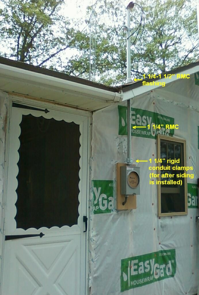

Below is an artist(?) rendering of what I'd like to do with the service entrance on my cottage. The pole is located at the corner of the house that is over a slab. The meter needs to be by the pole and the disconnect needs to be close to the meter--but I don't want the main breaker panel to be in that section of the house. I propose to mount a main disconnect on the other side of the (log) wall from the meter, run the wires from the socket to the main, then back through the socket and down the conduit & over to where the basement starts. This is where the breaker panel will be.
This seems to me to satisfy the NEC requirements as well as the POCO but I don't know if it's allowed to use the meter socket this way--that isn't covered in my wiring book.

You cannot have both fused and unfused conductors in the same raceway.

Drawing in 3D is beyond this "artists" capability I'm planning to use separate conduit for the "out" and "back". I don't think 2" rigid could hold 6 anyways. Or I may use cable for those short pieces.
It appears that the feeders from your meter socket or disconnect will be in exterior conduit until they reach the point where they will enter through the foundation directly into your main distribution panel. If so, why do you need a disconnect near the meter?
You didn't say whether you were planning to use a fused or an unfused disconnect. If it's unfused and the feeders are being run outside the cabin, what purpose does the disconnect serve? If it's fused and the feeders from it enter the meter socket, then you've used the meter socket as a raceway and placed both fused and unfused conductors in it.
Am I missing something here?
I thought NEC requires a fused disconnect as close as possible to the meter.
That may be an issue--I didn't view the meter socket as a "raceway" but I guess it can be interpreted that way.
Then I guess I will have to forego the "neatness and workmanlike appearance" of using the socket as a "hub" for the service wires. It's OK then to just use conduit & elbows after the disconnect?
Just so I understand the distinctions since such variations aren't covered in my book--there are meter sockets available that include main breakers or with unfused disconnect switches--why are those OK to have fused & unfused in the same box?
Yes, meter sockets are available with the disconnect/main breaker built into them, but will your power company accept one? You need to talk to your power company and see if they have a listing or service rule book that will have the approved metering devices listed in it.

A meter socket with the built in disconnect/breaker, the non-fused and fused wires are separated. With what you are proposing to do, they will be intermingled in the unfused socket.

Local electric inspector called me back today. From our discussion:
Use either type meter socket--the poco will have to install a meter to fit. This is the same suggestion an electrician at the supply house told me yesterday. I didn't know I could "force" the poco to upgrade my meter to the more common type.
With no need to support the weight of several yards of feeder wire from the pole a 1 1/4 mast will be fine as long as it's rigid conduit.
Bend radius where it goes through a wall is no issue as long as it's simply hand bent and not "hammered" into a sharp 90*.
He confirmed--and this may be a local interpretation--that a disconnect must be placed where the service wire enters the building. It would not be acceptable to to locate it in the main breaker panel 15 feet away--unless the feeders were run in conduit OUTside the building & enter AT the panel. He liked the idea of the main breaker next to the back door on the other side of the wall where the meter is mounted. I'm sure he sees this a lot in seasonal cottages.
That's usually a power company rule. Good luck finding a roof flashing that small. A 2" RMC mast is almost universally recognized as the minimum size allowed.

What is the clamp looking thing at the top of the meter socket hub? Where did you find your roof flashing, in the plumbing section?
  #35
Old 08-13-13, 11:30 AM
Join Date: Nov 2007
Location: MI
Posts: 2,614
See photo.
All items are from the electrical aisles at Home Depot.
