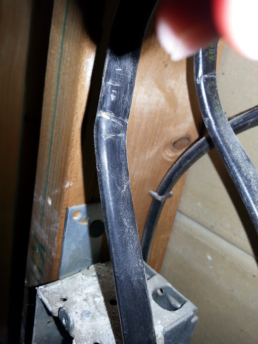

One of the cables feeding into the box I'm working on has a nick in the outer cable. The white wire is exposed for a fraction of an inch - not the wire itself, but the white covering. Is this a concern?
A different cable feeding into this box had some electrical tape wrapped around it between the box and the floor.
I took the tape off to discover this:
Do I need to do something with both of these, and if so, what?

Old 08-17-13, 03:20 PM
CasualJoe's Avatar
Join Date: Jan 2010
Posts: 9,221
-Connect the blacks and whites with 2 new pigtails each, and wire each receptacle with one set of pigtails.
I'd go with 2 pigtails from each, black and white. Yes, you'll have to repair the ground wires and also have 2 ground pigtails too.
What's up with the bulge under the tape, I couldn't tell from the picture, but it looks like an inline splice which would be a code violation.

Taping over the nick in the cable sheath, using a high quality tape such as 3M 33+ may be a sufficient repair for that cable. You should replace the section of cable that has the sheath open, with some of it possibly missing.
  #26
I'm assuming this means cutting the cable below that section, and then inserting a new section, joining the wires with wire nuts, and probably putting the junction in a new box nailed to the stud?
By the way, no inline splice. Just a damaged sheath. The cables inside don't appear to be damaged at all.
Correct, and the box must remain accessible.

The cable with the damaged sheath appears to go through a sill plate. Why don't you make the splice to the replacement cable in the basement?
That section of the "basement" is a cramped crawl-space with a small access-hole. I was able to make the splice above the floor, so no need to maneuver in the crawl space. The other half of the house has a full basement.
