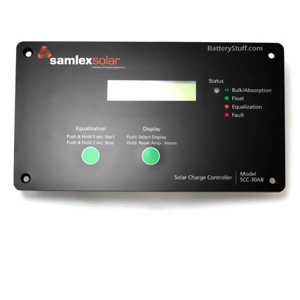

Additionally if you do not want to damage those new batterys from overcharging with the solar you need a good 3 or 4 stage charge controller. 4 stage will bulk, absorption, float, equalize . 3 stage leaves off the equilize part that will burn off the sulfur every so many hours.
Something like this will run $150 bucks or so.
