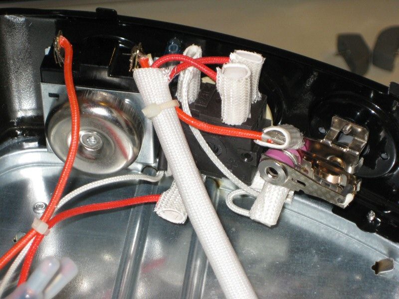

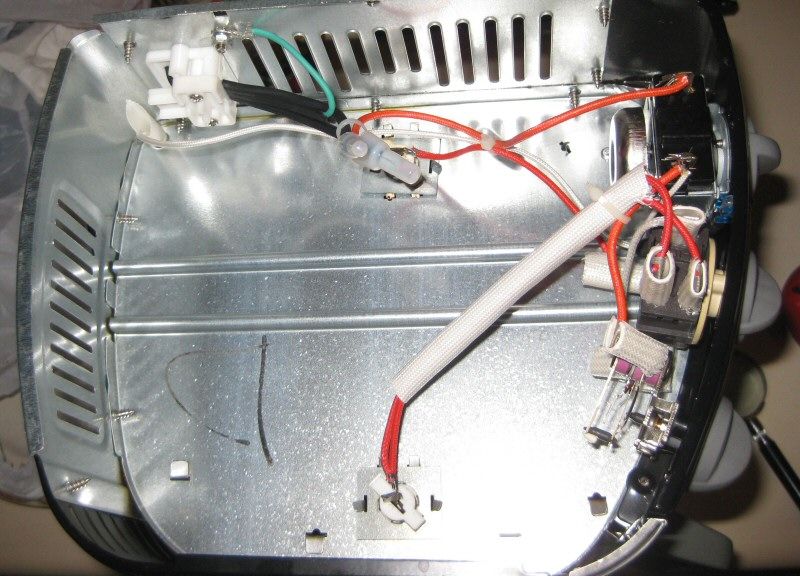

I want a toaster oven that I can use with my travel trailer's inverter. The inverter doesn't have the 1200W that the oven needs, and I've searched for lower wattage units but there isn't anything good. The oven has two heating elements, at top & bottom.
Upon some disassembly I see "550W" on each heating element, perfect. I'm hoping I can run the oven just using the bottom element, and it will take longer to heat up but that's Ok. I hope it will sustain 350 degrees with just the one element, cycling on more often.
I'd also like to be able to still use the oven for making toast, which necessitates operating the upper and lower elements alternately. It seems a properly wired standard 3-way switch could be used to manually switch between the two heating elements during toasting. A second standard switch could be used to activate both elements when I'm connected to real AC power in a campground.
I'm experienced with DC wiring but haven't done much with AC besides replacing wall switches and outlets. Does this project seem like something that's reasonably doable? Am I on the right track?
Below, the three controls along the right-hand side of the first image are, from top to bottom:
Timer / "always on" dial
Bake / Toast / Broil / Keep Warm selector
Temperature dial
The Temperature dial has an affect on all settings, even Toast.
When "Bake" or "Toast" is selected, both elements activate. "Toast" keeps the elements on longer for the initial cycle.
When "Broil" or "Keep Warm" is selected, only the top element activates.
Here are some pics, any help is appreciated!
The other side of the oven. Looks like just neutral wire to each element.

It would probably be simpler to wire a simple switch to each element rather than use a "3 way" switch.
Ordinary components and methods used for household wiring cannot be used here. You need componets and wire that will withstand the high temperatures inside the toaster.

AllanJ: It would be simpler to just wire two switches, but the 3-way switch would let me switch from one element to the other without the draw on the inverter going down and then right back up (I think). Plus it would keep them both from being on at the same time when the master switch is set to "off". As far as high temps...definitely a concern, I don't know if there are high temp switches out there.
