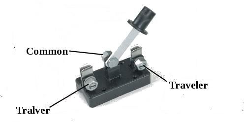

I dont know what a three way switch is.
A three way switch will have three screws plus a ground screw. Two brass screws, one dark gray screw, and a ground screw. It is used for controlling a light from two locations.
The B & W pair correct
Yes, of the 2-conductor cable.
Terminology:
  • 2-conductor cable contains a black and white wire plus usually a ground wire.
  • 3-conductor cable contains a black. red, and white wire plus usually a ground wire.
A 3-way switch is a single-pole, double-throw switch. It has one common terminal, often colored black, and two traveler terminals, often brass colored. When paired with a second 3-way switch and wired correctly, the pair of 3-way switches will turn the same load off or on from either location.
See How Light Switches Work. Also, a copy of Wiring Simplified will help you gain an understanding of the work you're trying to do.
The master bath switch is a triple 2 brass and a gray.
That sounds like a 3-way switch.
The red is on the brass and the others are bare.
The red wire is terminated to one of the brass traveler screw terminals; the other two screw terminals do not have wires terminated to them. Correct?
Blacks are plugged in the back of the switch.
The two black wires are terminated by being pushed into backstab holes. Each of them is terminated to the same terminal as the unused screw closest to the hole it's pushed into. The black wire in the 2-conductor cable should be terminated to the common terminal. The black wire in the 3-conductor cable should be terminated to the second traveler terminal. Is that how they're connected?
The wires in the backstab holes may have a poor connection.
Two copper connected by wire nut
The ground wires should be spliced by twisting them together, clockwise. The splice should be protected with a wire nut. The grounds should also be bonded to the box, if it's metal, and to the device - the switch.
as the whites the same way.
The two white neutral conductors are spliced together. This is definitely a 3-way switch, and it sounds like it's wired properly. Where is the other 3-way switch in this pair?

If the red in the bathroom and the red at the exterior are common there are three lights involved.
In a properly wired 3-way switch system, the common terminal on one of the switches is connected to the incoming ungrounded potential ("hot power") from the breaker or fuse. The common terminal on the other, paired switch is connected to the wire that feeds the ungrounded ("hot") power to the load.
The two travelers are two of the three wires in the 3-conductor cable. Usually the red and black are chosen, but it could be the red and white or the black and white. Regardless, the red wire should not be connected to the common terminal on either switch, 99% of the time

Saw 3 reds. Two work on one light that is functional and the third red does not.
Hence the "other common"
Only two commons per three way switch circuit. One common at each switch box.
Here is a graphic representation of the parts of a 3-way switch:
And here's an actual switch:

Have two reds on a working switch and working light.
The third red doesnt work that light and so far havent found the other red (pair)
