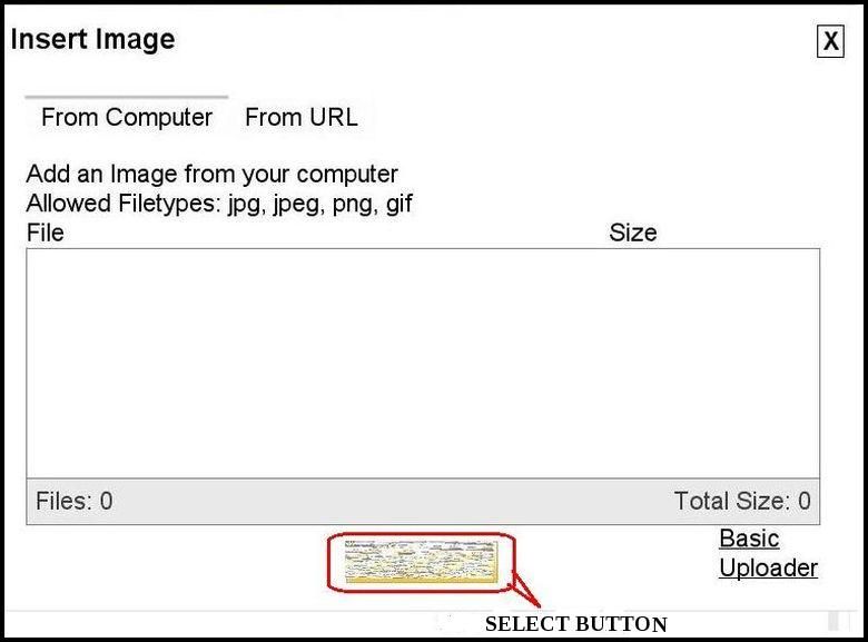

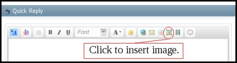

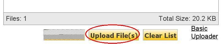

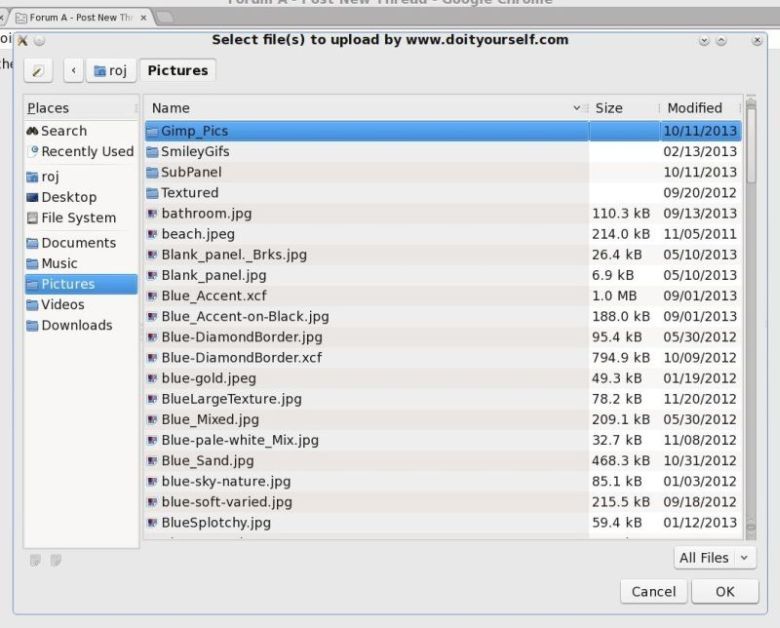

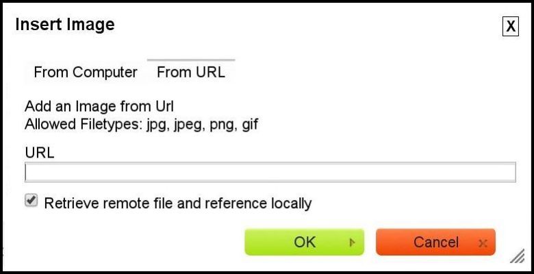

You can't post pictures on your computer. They have to be uploaded to a server such as Photobucket or Image Shack or a Server here.
Pictures can be worth a thousand words but just how do you add those pictures? You have two choices. You can upload to the forums or you can upload to an image hosting site.
Either way you start by clicking on the upload image icon in the toolbar at the top of the compose box of the Advanced Composer. Quick compose no longer has this feature.
This brings up the insert dialog. By default the insert dialog is set to the choice for uploading from your computer. You would click select file at the bottom to select a file from your computer.
Then you would choose the file from your computer and left click the file.
Then back at the compose screen click Upload Files:
