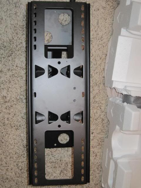

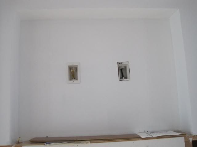

PC Boss, I have some Arlington boxes already. I put them in above my fireplace in living room and bedroom where I planned for TV. The TV I am putting up was not planned but seemed like nice room to have one. Here is my living room:
close up of box:
problem is the wall mount I have won't work with these boxes as the cutout on wall plate isn't big enough:
so here is what I am doing:
on left is going to be receptacle and right is low voltage. Only issue I see is that when TV is pushed all the way against wall, it may crush cords. I won't know for sure until I get everything hooked up. I may but Leviton recessed duplex box and then get new cord as mentioned above because I will be plugged in my soundbar here as well. I was going to use a Leviton surge suppression receptacle here, but I am pretty sure that the cords will get hit if I don't recess receptacle. The problem with the Leviton recessed receptacle is that it has receptacle integrated with face plate-I can't use my surge suppression receptacle. I am looking for recessed setup that is standard size that will let me use my own surge suppression receptacle. I like the powerbridge setup mentioned above as it would let me connect TV to surge suppression device that I could put in hidden cabinet below TV, but the problem is that it only provides one receptacle up near TV and I need two-one for TV and one for soundbar.

Those surge suppressor receptacles aren't going to offer you much protection - especially given what they cost. The better way is to install one of the inlet plates I mentioned down below, and that will allow you to plug the TV into a quality surge strip with a connected equipment warranty.
And FYI those holes are not designed to be a place for you to mount the boxes - because they are right where the bars fold into, and yes you will crush things. You're supposed to install them above or below the bracket.
