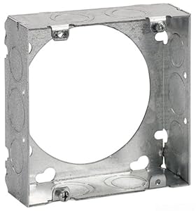

What exactly is an extension ring?

an extension ring with a cover

- Extension ring with an L16 and blank cover.

You are correct. I meant to say that the DECORA PLATE is surfaced mounted, but the BOX is recessed mounted. It WOULD indeed look quite ugly to have that box surface mounted
