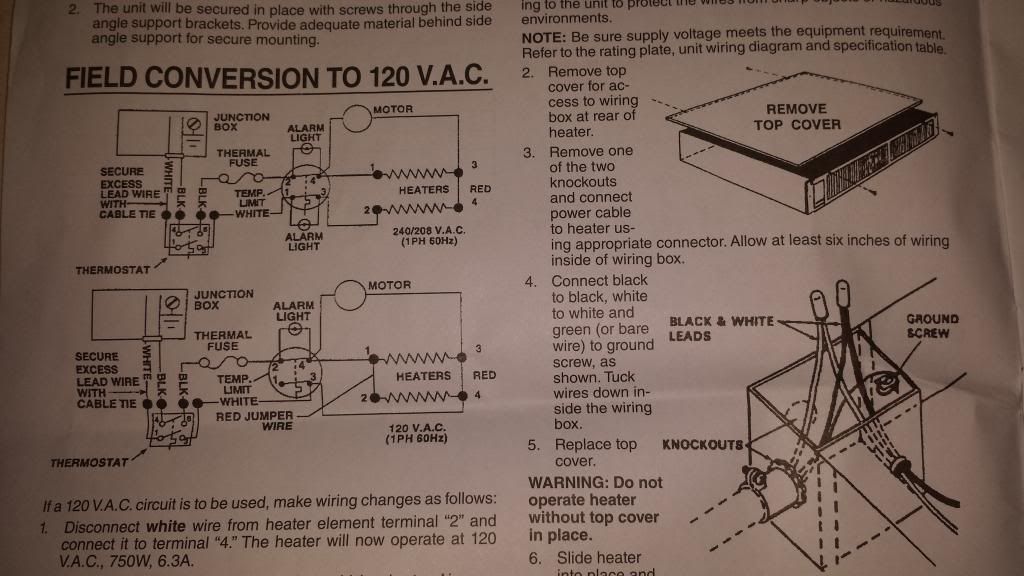

I got this toe kick heater in the kitchen that died. I bought a new one and you need to wire it either 240 or 120. I have no idea what the old one was. They wired the thing to a cheap thermostat but also tied a baseboard to it. In other words the toe kick and baseboard are tied to one thermostat. All that I was left with from the old heater was a single white/black/ground. Itís also a single breaker. I could post pictures.

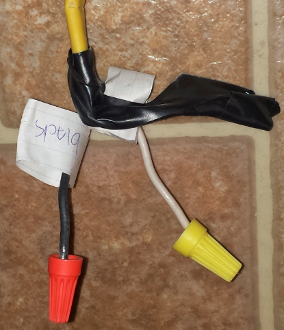

Hookup (and where I would test)

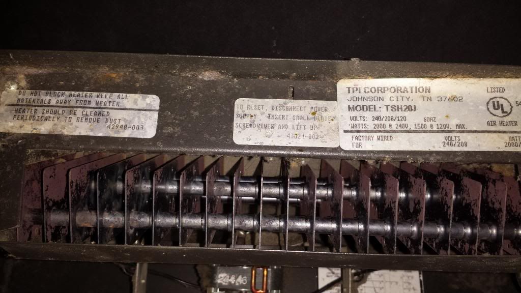

Sticker on old Toe Kick:
One more old Toe kick:

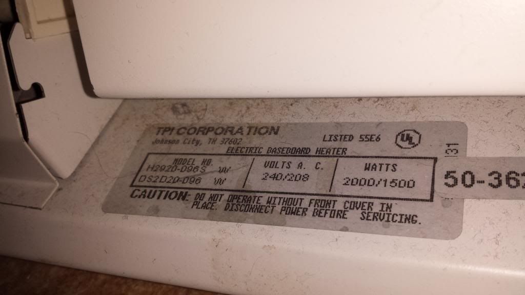

Label on the Shared Baseboard

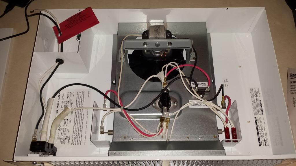

New Broan series 112 Toe Kick:

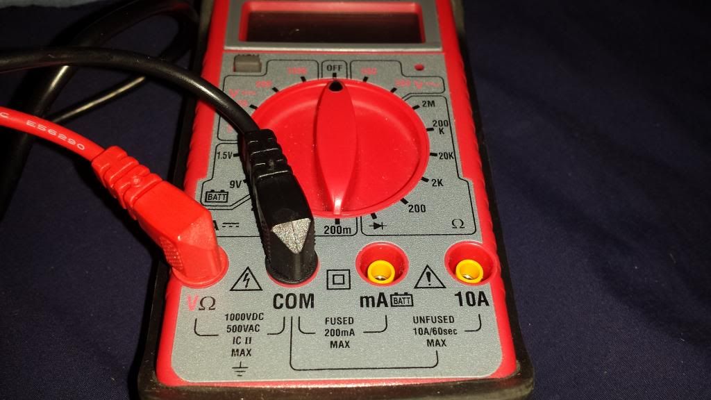

My MM:
So I would set that MM on 500~ and the nodes I believe are in the correct places. Here is a link to the new Toe Kick unit on HS Broan 19-1/4 in. 1,500-Watt Kick Space Heater with Built-in Thermostat-112 at The Home Depot

Yes, 500v would be fine and your leads are in to correct place.
You have a two pole breaker which indicates it is 240 volts, and the baseboard heater is marked 208/240 volts. You vary likely have a 240 volts there but it doesn't (shouldn't ) hurt to check, again, Carefully!
It appears that the unit is factory wired for 240 volts but this should be confirmed on your end.

If your new heater has to be field converted to use 120V power it should be wired to use 240V. You have 240V. It should be ready to hook up.
The black and white wires that were connected to the old heater are both hot wires. Mark the white one with a bit of electrical tape or permanent marker to show that.

Ok, but its still white to white and black to black (plus the ground) correct?
Sure. Or white to black and black to white. With single-phase 240V power one way is as good as the other.
