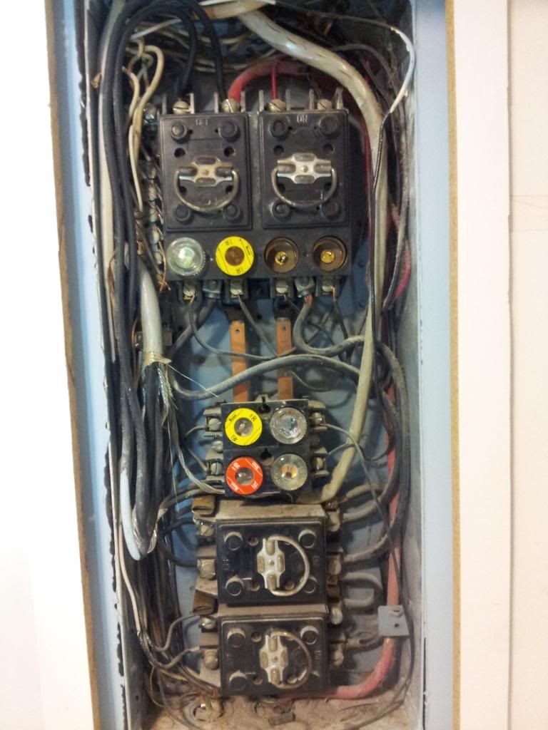

I guess I'll try posting a picture. You could be right.. I'm confused and stumped as to what happened and I'm clearly a novice with this stuff. In the pictures you can see the two fuses are taken out. Those are the ones that "blew" I took them out and replaced them with 2 different fuses and nothing. You can see they both have a nice like black mark and metal like it welded it. Also to the fuses it blew there are pieces of metal from the inside of that. It looks like it tack welded to it almost. Anyways anything that's on the top right fuse cartridge holder has no power. My uncle came over with a voltmeter or something and was testing things in there and said the new fuses and cartridges i was putting were good but he didn't check the old ones honestly.. Maybe that helps? Hopefully posting the picture this way will work, because I sure can't figure it out any other way.
The top right fuseholder has nothing to do with the two screw-in fuses that are removed. That fuseholder is what is commonly referred to as the range pullout and normally is used to fuse a circuit to a heavier electric range circuit which connects at the two terminals above that pullout. In your case, it appears the range pullout is being used for a lighter circuit.....note the smaller wires at those two terminals above the pullout.
