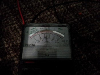

Using a meter, what reading (select AC volts, at least 120) do you get measuring between the ground hole on one of the suspected receptacles and the ground hole on a known good receptacle (say, in the next room)?
I have posted a photo of the reading I get when doing the measurement between the 2 ground prongs like you said. I am not good at reading these things, sorry.

NOTE: The photo attached is the result of measuring between the ground of a good outlet and the ground of one of the 'bad' livingroom outlets. It is also the result of measuring between the ground of the livingroom outlet and the coax cable. Both tests yielded the same result. The meter is set at 250V setting.I know the photo is small but hopefully you can read it. Seems to me to be up near the 240 mark but not sure if I am reading the right line.
A better quality photo can be found here. Hopefully this is allowed.

We're here. You read the bottom scale and double it. So you were reading about 120 volts.

Somehow there is 120 volts on the ground pin.

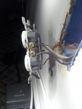

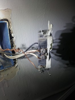

Ok, I was able to quickly get down there to shut off power. I took photos on only one of the outlets, I can take photos of the other later or take photos of a working outlet if that will help. I will post the images below.
Meter reading
Right side outlet
Left side outlet
So I guess what I am confused about is how can the outlets test as properly terminated with an outlet tester if there is 120v to the ground?

I approved your pics and they should be visible now.
You do have a wiring problem there. Not only is there a jumper from ground to neutral.... the neutral and hot must also be reversed.
You are going to need to identify the receptacles on this circuit so that you can check each one for the wiring problem. Since you measure/and have hot on the ground...... and a jumper from neutral to ground is present.... you should find white connecting to black in one of the receptacles ahead of this one.

Exactly what I thought. As Pete said, a receptacle on this same circuit is wired with hot on silver screws and neutrals on gold screws, which is messing up the "polarity", and that ground wire is totally out of place, and is causing your problems. Keep us informed as to what you find on the other receptacles.

To make it right, you must pull the other receptacle. You will find the white and black wires reversed on it. Make the change there. First remove the grounding wire from the neutral screw and cut it back on this receptacle. Then reapply power to the circuit. Test from ground to white and from ground to black. Let us know what you find.

No. The primary problem is the hot/neutral reverse elsewhere but the bootleg ground at that receptacle is a code and safety violation that must also be corrected.I'm guessing when the jumper is removed to correct that problem the whole circuit may loose its grounding and you will have a second problem to correct.

You have two known problems both of which are shock hazards. A bootleg ground, ground wire jumpered to neutral and and reverse hot/neutral. But the bootleg ground may indicate a third problem, the whole circuit has lost its ground and the jumper was an improper and dangerous fix.

Except for the lack of a wirenut on the grounds and the whites going the wrong way under the screws there is nothing out of the ordinary showing.
