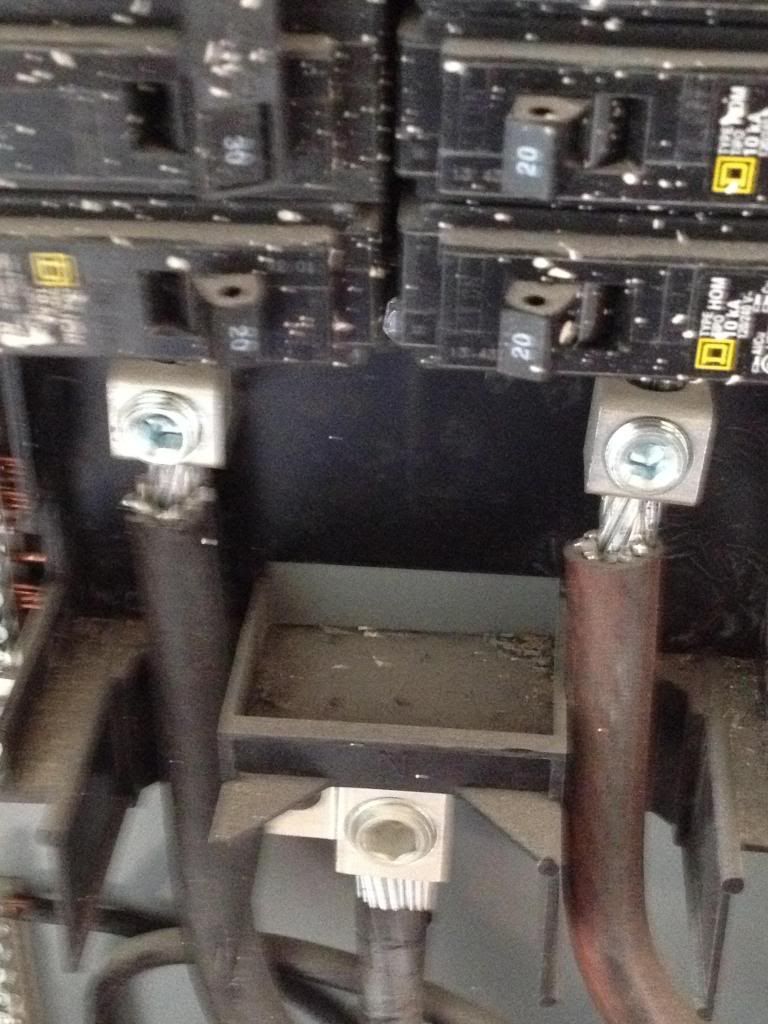

New 200 amp main lug panel in a church hall remodel. 200 amp service. 200 amp disconnect outside feeding 3 wire 4/0 Al to a 200 amp panel which feeds everything. Kitchen has two double ovens, one freestanding stove/oven and one stovetop plus two microwaves. Electric hot water and two 4ton-ish air conditioners.
Im pretty sure those lugs are going to burn off the first Sunday the kitchen gets used, but I what do I know.

The issue is that we no longer know the ampacity of the conductors. They may now be too small for the expected load.

What is 4/0 AL rated at with 13-15 strands trimmed off in order to fit in 2/0 lugs?

The is no way to know the remaining ampacity. It needs to be fixed.

I find it odd that a 200 amp panel would not have lugs big enough for 4/0 wire. Especially a newer one like the Square D Homeline you have. Most panels rated for 200 amps will have lugs rated for 250 MCM or larger as a 200 amp residential service will require 4/0 aluminum. Are you sure that panel is rated for 200 amps?

Im not sure what the rating is. I think it was converted from a main breaker panel. Where would I find the label?

The label should be inside the panel on the side.
That panel has an awful lot of dirt in it to be a new panel.

If it is truly a 200 amp panel, the wrong lugs were installed. The fix would be to just install the proper sized lugs. The panel rating needs to be confirmed first.

I bought the right lugs for the EC. He is not taking the hint. I just wanted to make sure I had my ducks in a row before I call him out on his hackery.
I guess I won't even mention since the ouside service disconnect was replaced as was the inside panel, this should now be a four wire feeder, correct?

I think you have an issue to address with your contractor and with the inspector too, a serious issue. Was this inspected? I don't know an inspector who would have passed an installation like that.
Yes and there should be a separate grounding bar. The grounds and neutrals can no longer be in the same bar as this is considered a sub panel.

Permit is in the window, it passed rought in and yes I am still scratching my head how it passed.

I didn't see the trimmed strands when I first posted*, maybe the inspector didn't either.
