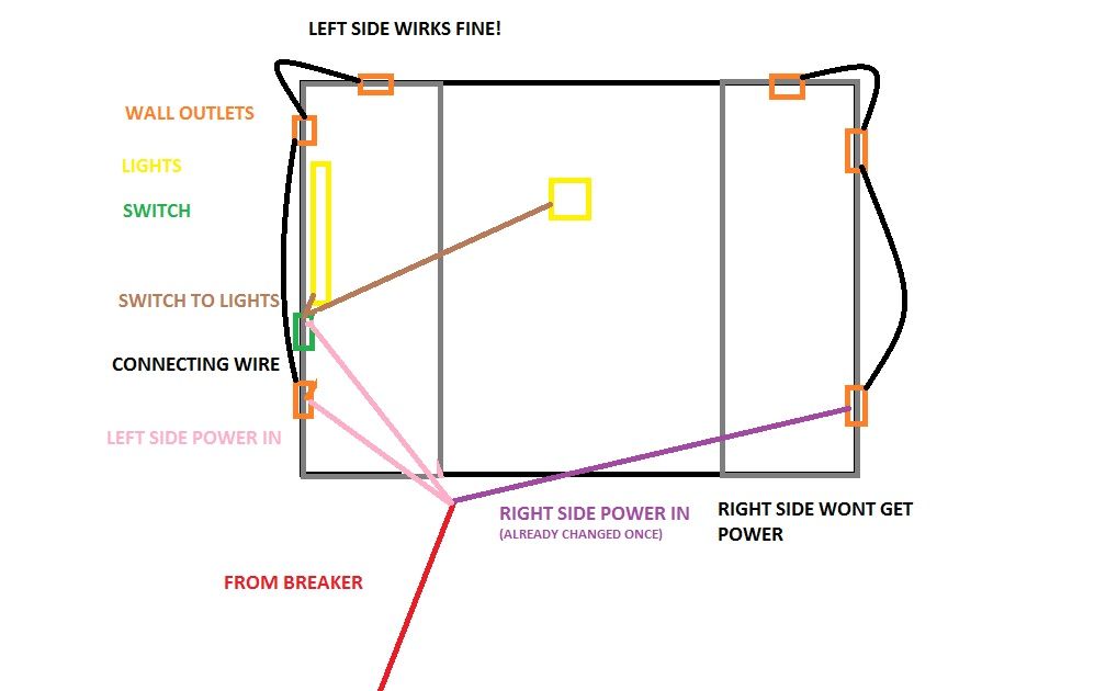

OK.. that may be a stretch.. but it's sure got me stumped.
Short version. 1985 1700sqf. house. Was stripped of wire while vacant. We're rewiring, connecting to what wire is still there in working condition otherwise running all new. House is wired Black=hot, White=return/neutral, bare=ground. Most of the house is wiring up as expected... BUT
The kitchen has me stumped. Kitchen is on newly run wire from the breaker, it then makes a "T" one side going to the left and the other to the right. Left side works fine, but the right shows open neutral and won't deliver adequate power.
My first thought was the wire going to the right must have a break or short... so I replaced that segment AND checked for continuity before installing to make sure it wasn't shorting somewhere inside. After replacing the line.. I checked again and somehow it showed contact between all three wires!
So I'm thinking how in the world? It's only a 6 foot length of wire going basically in a straight line, how is one side of the "T" working fine but this side is no good? This goes against my understanding of basic electrical theory, if it's really shorted that bad how would the other side work? So I'm hoping someone can tell me what is happening. At current I have the left side hooked up and the other capped off in the attic... and I just don't understand why power won't make it to the other side of the "T". Thanks
http://i58.tiny pic. com/ipo1w2.jpg -open and remove spaces to see diagram of wiring.

The walls were never opened... the wire was cut and taken from in the attic, so where possible I'm trying to avoid destroying walls. One of my first thoughts for why I was getting "open neutral" was that one of the wall plugs on that side was miswired/bad, but even when I take those completely out of the loop I still don't get proper voltage on the wires. (and the wire going down to the receptacles has been replaced too... as that was the second thought.. if not the plug, the old wire. So now it has new wire on the problem side both down the wall and joining to the "T" that goes to the breaker. It's an uninterrupted path: breaker - split to "T" - line to wall - line down wall. All new wire, replaced everything after the "T" once already, yet the same issue. I don't get how the power can flow one way off the "T" no problem and not the other way equally. If something on the "good" side were improperly wired why would all the plugs and lights work?
Have you tested right side hot to ground? What reading do you get? I know it is redundant, but check the connections in the junction box where you spider out to each side, especially the neutral connection. If any of your receptacles utilize the stab back feature, remove the wires to under the screw heads.
Turn off the power. Unplug everything and switch off all ceiling and built in lights.
Using a multimeter in the ohms or resistance or continuity setting (and a long wire extension for one of the meter probes), do a recheck, measuring between the black tee and the wall plug (receptacle) prong slots. Repeat for the white tee and the prong slots. Ignore the third (round) prong hole for now.
You should get continuity between the black tee and one prong slot, and get continuity between the white tee and the other prong slot. No continuity for the other combinations.
Correctly (after you get it working first) the shorter prong slot is for the hot side. Looking at a three hole 120 volt wall plug, the sequence is (clockwise) earth, neutral, hot.

Thanks for your replies AllanJ and chandler.
Hot to ground gives me 138 (a little high due to cheap meter) on both sides of the kitchen, but hot to neutral on the bad side only reads 90 and wont even power a LED nightlight. Good side reads 138 and works to power anything.
I've completely rewired the junction 3 times now, with no change.
The only thought I have is that somehow the switches are grounding out, but why would that only affect one side? That's the thing that really bewilders me. I can't conceive there being any hidden wire that somehow connects the lights to the other side of the kitchen, and even if there was... since it's all the same circuit why not mess the whole thing up?

Two things, the receptacle circuit should not also power the lights. Also what are the connections at the switch box?
Come to think of it, a bad connection in a stab back is a likely cause of the problem you describe.
Your meter is not fibbing regardless of how cheap it is....

Yes I know it's not exactly code for lights to be on the same breaker, but I liked the idea of one trip on the GFI stopping everything should a fault occur at any place in the kitchen... I do need to go ahead and just separate those thou...
Materials needed: A table lamp fixture or portable lamp fixture for 100 watt incandescent lamp with a cord ending in two alligator clips instead of a cord cap. A fifty foot length of single conductor wire with alligator clips on its ends. A multimeter. A piece of metal that will fit in a prong hole of a wall plug and stick out a little.
LOL... I think I'll just use my double ended extension cord.. but I get the idea... we did that on another circuit to find out which receptacles were in the loop.
We had a second digital multimeter when we started (bad 220 breaker blew it) and it gave a reading in the 127 range... but if there is a neutral problem in the wiring of the house that could certainly be causing issue. (could you refer me to some relevant threads on the issue?)
The light switch box? One live going in, one switch to a over sink florescent, the other to a small fan, standard single pole switch wiring.

138VAC is not induced voltage. High impendence or not, this guy has a serious issue that doesn't fall into the tolerances of phantom voltage. Using a "cheap analog multimeter" will not change this for the OP.
