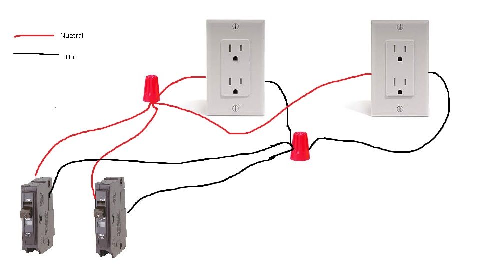

Would this be the correct way of wiring it. Just so you know I only have 4 outlets on the kitchen for small appliances and I was going to split them up. Meaning every 2 outlets would be on their own dedicated circuit. So do I now need 4 breakers for 2 circuits or am I over complicating this?

You only need one breaker per circuit. If you were to splice a hot from each breaker it may trip the breaker as it would be a short to the opposite leg of the panel.

Electrically that is correct, but since this is a small appliance branch circuit, the way you have drawn it both devices will have to be GFCI receptacles. What I would do is use a GFCI receptacle as the first receptacle and wire the second duplex receptacle from the LOAD terminals of the GFCI device.

The latest diagram shown would be correct for one circuit but would require two gfis. If power is fed into box 1 line terminals, box 2 will be fed from the load terminals to a regular duplex. No pigtail except for ground will be needed. Repeat for other circuit.

Rays diagram is correct for two GFI receptacles..

Not necessary. The downstream can be protected by the first GFI if wired from the load terminals.
