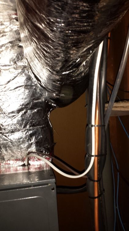

In a previous post on a separate issue, it was pointed out to me in one of my pictures that the 240V line should not be ziptied as shown below.
What is the acceptable attachment method? With exposed joist bays, is it acceptable to staple to the face of the joist? I know with 12/2 and 14/2 you need to have a runner board, but have never personally installed any 240V.

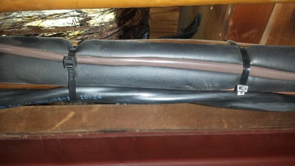

In some instances, the cable is supported as a bundle with the A/C plumbing lines as shown below. Is this acceptable?

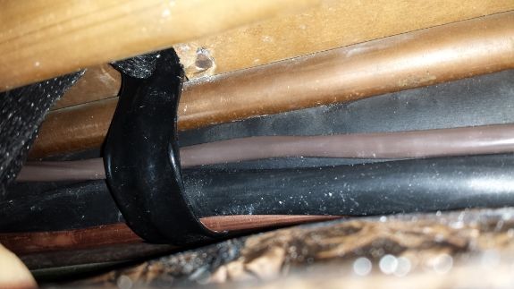

Is it ok to turn the 240V between two plumbing lines as shown below? The red arrosws are the two 240V lines. I know both should be better stapled to the joist, but was unsure if running between the two pipes was acceptable.
The wiring is also resting on my baseboard hot water pipes from my boiler. Is that acceptable?

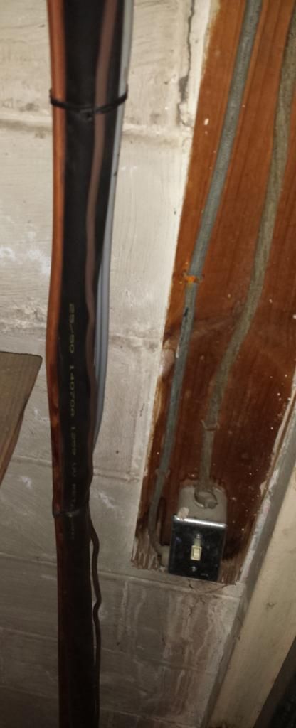

My final question is just basically an extension of the first one. In the vertical run to get outside to the compressor, the 240V is also zip tied. What would be an acceptable manner of supporting the wire in this instance with the concrete wall?
That's right, cables ziptied to the refrigerant lines are a code violation.
Is this a basement or a crawl space. If a basement, I'd run the NM cable through holes bored in the joists. If a crawl space, I'd probably use a running board on the bottom of the joists.
No
Running NM cable between the pipes is acceptable if they are properly supported. Why do you have two 240 volt cables running the the outside heat pump?
I don't think the heating pipes will damage the cable, but the cable is not installed or secured properly.
You should have conduit running down the face of the masonry wall with an LB fitting to go through the wall. What does the outside look like? Is there a proper NEMA 3R raintight disconnect at the heat pump? Is the line voltage wiring in conduit to the unit?
It's two separate circuits. One 240V from the breaker box to the air handler and one 240V from the breaker box to the condenser. Would correct stapling at the proper distances make this properly supported?
What would be proper installing/securing? Is it just better stapling?
Is it a correct interpretation of this comment that just running the UF cable through a PVC pipe in the wall with the other connections (shown below) is not correct?
Better stapling and keeping it off the piping and ductwork.
Yes, it is not correct. I don't see a need to have used UF cable at all. I would have run conduit down the face of the wall inside and through the wall approximately 12" above the refrigerant line penetration and directly into the back of the disconnect so that no cable would be exposed outside.
