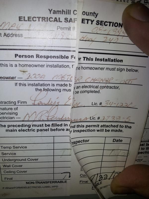

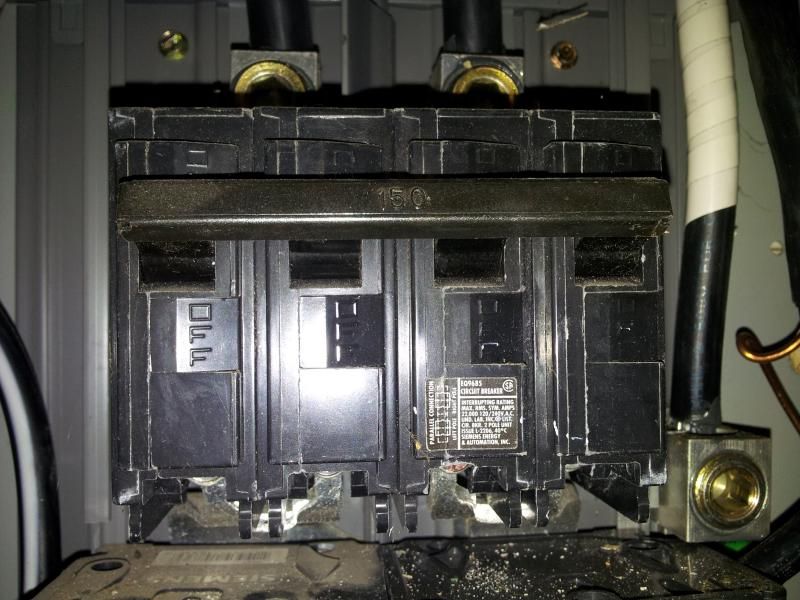

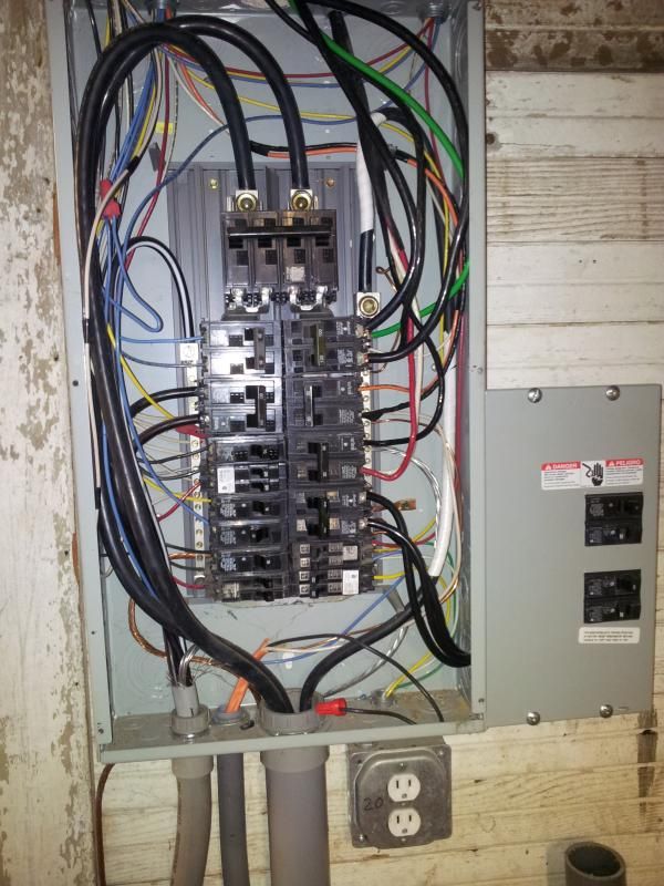

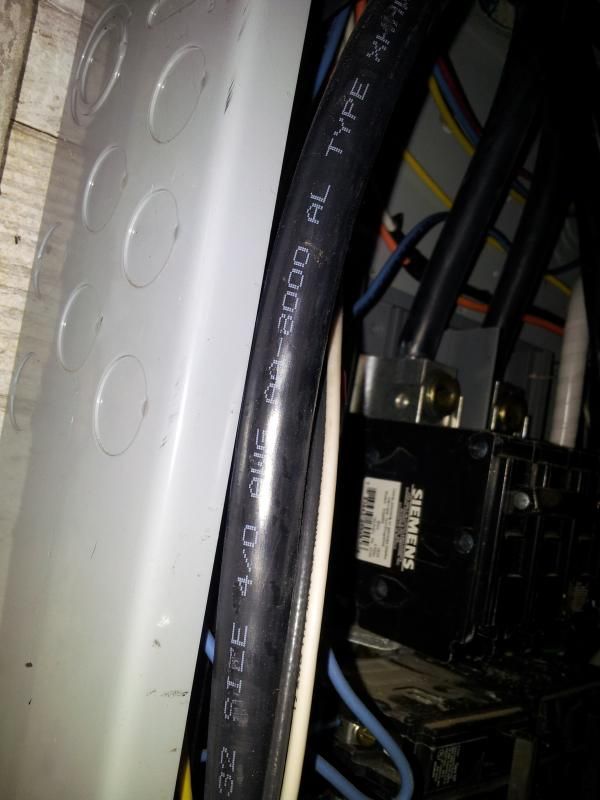

I finally got around to pulling the cover off the panel. 4/0 aluminum from the meter to the panel. I also noticed the old permit stuck to the panel says "200A meter change out".
All I need to do is change out the 150A breaker for a 200, right?

You are going to need to check the ampacity of the panel bus to see if the main can be swapped for a 200. The label from the manufacturer should have this information.

Is there space on the left side of the existing panel for a 2nd panel similar to the existing panel ?
if so, then consider setting such a panel so that the 200 amp MCB would be at the "bottom' of the panel; you have sufficient "slack" in 0000 conductors for them to extend to MCB of the 2nd panel if it's "at the bottom"
Also, you'll double the number of CB positions.
You will have to transfer the Grounding-connections to the new panel.
