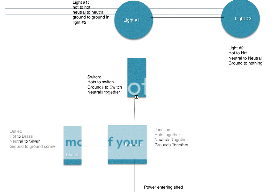

I worked all day yesterday digging a trench out to my shed and running 12/2 wire in PVC conduit to put in an outlet and two overhead lights.
Here is the issue I am having:
Light switch on:
Top outlet "hot/ground reverse"
Bottom outlet "Hot/ground reverse"
Light switch off:
Top outlet correct
Bottom outlet correct
I know that sometimes the hot/ground reverse can mean an open neutral somewhere as far as the 3 prong testers go, but I have triple checked all the neutral (and everything else).
Here is how I have it wired.
Any ideas?
Does that look correct?

Just as a double check with the exception of the disconnect is this how you have it wired?

I do not have a switch in what you have labelled the disconnect. I only have a junction box there with hot to hot, neutral to neutral, and ground to ground. Otherwise, yes, that's exactly what I have.
Thanks for taking the time to work on this!

FIXED!!!!!!!
When I stripped back the 12/2UF in the sub panel I must have severed the neutral. When I took it out of the bus bar and gave it a little tug it broke off right at the point where I stripped it back.
Lights work and outlets works out at the shed now.
