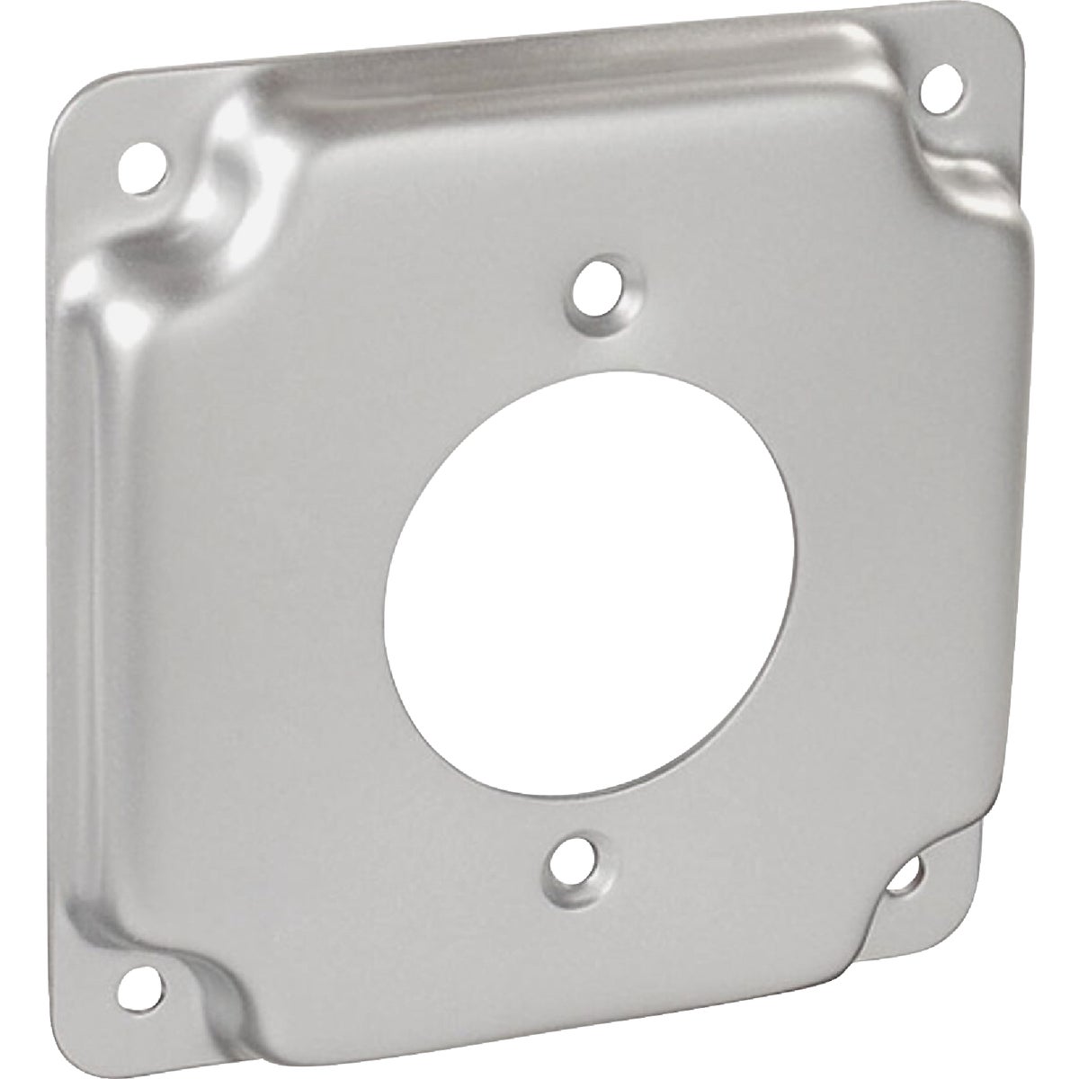

Sorry, I must be having a brain cramp. How do I attach the receptacle in #7 to a 4" box when all the ones I've found only have screw holes in two corners?
Thanks

Normally the receptacle attaches to the cover plate not the box.

You can also get covers that have 4 screws in them for a little extra support.
All taylor covers are designed that way, device attaches to the plate and the plate attaches to the box.
Okay and yes the R has those holes so that clears that up.
Yes, I can find all kinds of covers with 4 screws but I'll be damned if I can find one box that will accept 4 corner screws. All the boxes I've found have two places for corner screws.
Thanks guys, I have to get off this machine before I go blind.

Ok I understand your question now.
Your cover has 4 holes so it can fit on your box properly no matter how the box is rotated.
Look at your cover and envision only two holes on it, now envision the box being rotated so the screws are opposite to where they are sitting. Your cover would no longer fit to keep the device aligned properly.
2 screws is all it takes to mount something on a 4x4 box.

Not boxes with four screws plates with four screws.

Alrighty then, no wonder I couldn't find one. Two screws it is.
