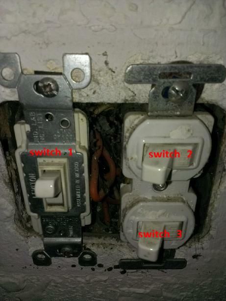

There is a switch in one room I never figured out what it's for and finally I decided to open up the switch plate and peek inside.
There are three switch.
Switch 1 operates a ceiling fan.
Switch 2 (top) operates a back porch sconce.
Switch 3 (bottom) is the mystery switch.

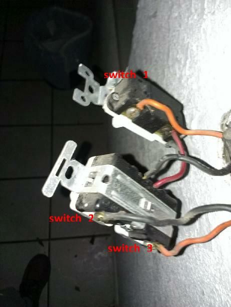

Once I looked at how switch 3 is wired, I am confused. See the picture below.
Looking at the back side, there is a hot orange conductor that goes to switch 1, the red switched leg then jumps to switch 3, and from there to the ceiling fan.
So switch 1 and switch 3 are two switches in series for the ceiling fan?
Does it make any sort of sense?
Problem is switch 3 does not work, it does not really do anything to turn on or off the fan. May be switch doesn't work.
I am just perplexed may be there could be a valid reason for this that is not obvious to me. Is there?

If switch three wasn't working.... you'd have something that wouldn't turn on. Maybe that orange wire was run to a splice box and capped for future use.
Ahhh OK, I assumed the black conductor and the orange conductor (they came in through the same conduit) are two hots from the same circuit. You are right, the orange is a switched conductor to "Load 1" the ceiling fan. Load 2 is the back porch light. Now I need to find where Load 3 goes to.
Thanks for straightening me out!

If 3 doesn't go to a light, it may go to a receptacle in the room.
With 3 off, check each receptacle with a plug in tester. Check both top and bottom of receptacles. When receptacles are switched, it's normally half-switched and the other half is always hot.

Which direction does the conduit go? That's usually a good clue as to whereit ends up. The first thing I would do after checking the outlets is open up a few boxes and look for an orange wire. My personal guess would be that it's for a light kit on a fan.
Also-you're in a house right? If you're not, be careful as in my area orange is used to identify the high leg on delta systems, or as a phase conductor in 480/277V systems.
