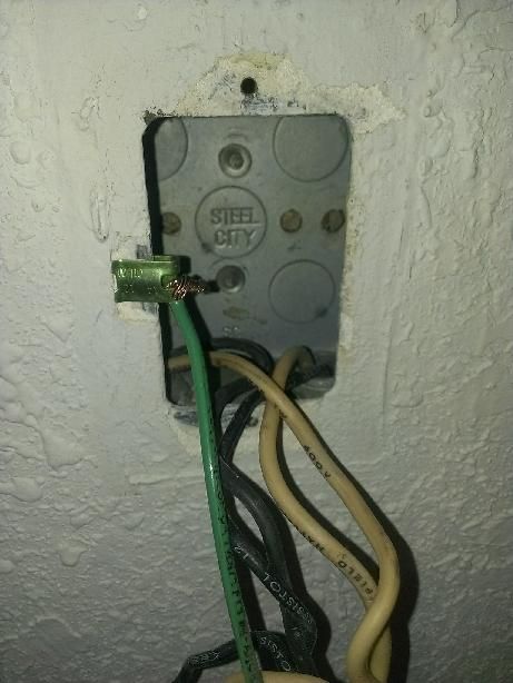

I have a bunch of old 1960s existing boxes where the devices weren't grounded.
Everything is EMT with metal boxes. So all I need to do is to bond a ground wire from the device to the box.
Interior walls are no issue, I can drill a hole through the metal box for a ground screw.
Exterior walls is where I run into problems. The boxes are shot into concrete walls, and these old boxes do not have a raised section on the back side to accommodate the ground screw.
I understand that in this case a ground clip can be used. However this is an existing box with an existing mud ring, so I can't attach the clip to the edges of the metal box, I need to attach it to the inside edge of the mud ring? Is that how it is supposed to be used?
But the mud ring is raised in the middle, so the clip won't actually fully sit all the way in. In any case I think grounding clips won't work either.
Any advice on how to do this?
I know one solution is to scrap off the section of the mud ring that's painted, then use self grounding switches and receptacles. For another reason I don't want to use self grounding devices.
Is drilling a hole in the mud ring and tying a ground wire to that one option?
I believe code requires a green self threading screw so if you drill and tap for a green ground screw you should be ok. Nor really much other choice other than pulling a ground wire thru the conduit.

if I just drill the metal box with a regular bit the bit would make it half way through the metal and be stopped by the concrete behind it. If I then use a concrete bit it will probably chew through the hole and ruin the threads.

Drill and tap the hole in the cover plate.

Plaster rings typically have a curved surface that would not allow the clip to fit properly.
Self grounding would be much less hassle.

I would probably run a small bit in the hammer drill through one of the factory holes in the back of the box to remove some material, then just drive in the ground screw, impact drive if necessary. You could also shorten the ground screws a little bit with side cutters if it's too difficult to drive all the way. If that fails spectacularly then back to the drawing board, but it's worth a shot.

I don't think you will ruin the hole by drilling twice. The ground screws are self-tapping.
So just drill a hole in back of box with regular bit, a little smaller than ground screw.
Go through that hole with a diamond bit, a little smaller. All you need to do is clear out about 3/8" of concrete.
Use a drill/driver to drive in ground screw using a magnetic hex head bit. The screw will cut it's own threads.

I did the concrete drilling and taped a hole, no good, when driving the ground screw it just spins and spins. I think it can't get past the smaller hole in the concrete.
After some thinking there are only two options that come to mind, both not very attractive and laborious.
(1) Drill a ground screw size hole in the metal, then drill a smaller size hole beyond the first hole in the concrete; then use a smaller concrete bit and drill at an angle through the metal hole into the concrete, hoping to break up more of the concrete without enlarging the metal hole. Do this all the way around, drilling half a dozen spots. Then secure the ground screw to the tapped hole.
or
(2) cut into the edge of the metal box, break up the sheet rock around the mud ring, and expose the entire mud ring. Back out the two screws and remove the mud ring, then use a grounding clip on the side of the box. Put back the mud ring then reapply new joint compound to refinish the wall.
Not really what I want to do, but seems this should be a common problem and there is really no clean solution?

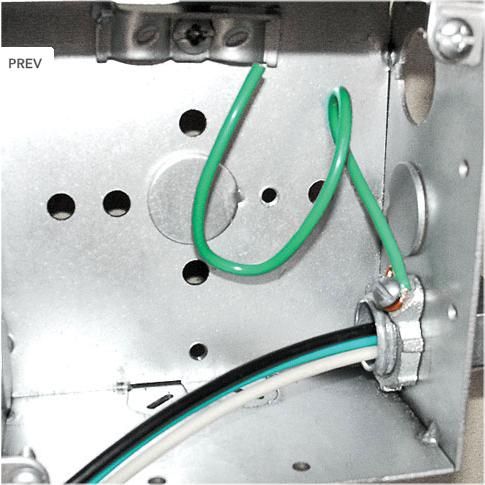

OK this is an older thread, and what I ended up doing, which was insanely laborious was using a combination of methods. In some cases where it's a single 1 gang receptacle I used a self grounding receptacle, in other cases where it's not concrete behind the method box like interior walls, I used tapped a new hole in the back of the box and thread in a ground screw, in a few cases I have two gang boxes with multiple switches and concrete behind the box I end up enlarging the sheet rock hole enough with a multitool to expose the old mud ring fully, removed the mud ring so I can insert a grounding clip and put the mud ring back in, in one case there was only one conduit feeding the box I end up removing the box from the concrete block wall, and put in a new metal box with a raised ground screw hole.
However, a few days ago I was browsing through Garvin Industries web site and I saw a product that I could have used I didn't even know existed...a locknut with an integrated grounding hole!
I just wanted to share because if I knew about it it could have saved me a bunch of time.

The only issue I see with that locknut is there is no way you could spin it 360 degrees. The screw bump would hit the side of the box and you couldn't tighten it.

That's a nifty device and I've never seen or heard of them.
I think what you did was better though. I would like to see the ground wire securely attached directly to box. A ground screw is the ideal way, a clip will do the job. This ring has room for failure.
That is probably why the major manufacturers haven't developed their own version of this product.
Possibly, I guess that depends on the depth of the metal box, and whether you have other connectors immediately adjacent that would interfere with the nut rotating 360. I had at times not even able to rotate a 3/4" lock nut if the adjacent connectors are 3/4". May be with 1/2" connectors this works.
Another potential issue is the screw kind of have to face out for someone to tighten it down with a regular screwdriver, so if you turn and turn to tighten it down and it ends up on the other side of the box opening you have to swing it back around. I could see much of it depends on how much room you have to work with. If you have an existing two gang metal box with a single device mud ring under the finished wall, it's going to be difficult to use a screw driver to secure a ground screw unless it's for the top or bottom middle connectors.
I think it would be more useful, if this grounding lock nut is made as a "ring" or washer. You turn the ring to face wherever you want and put it onto the male threaded connector, then you put a regular lock nut over it to tighten, so it goes between the lock nut and the inside of the box.
