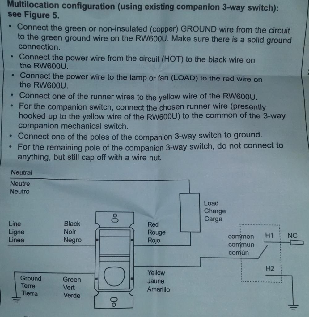

Here is the instructions provided with the occupancy sensor:

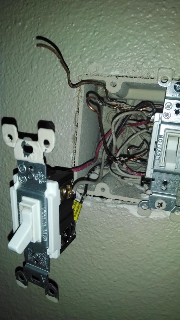

Here is the location where I would like to put the occupancy sensor:
All the wires are coming from one singe romax at this location.

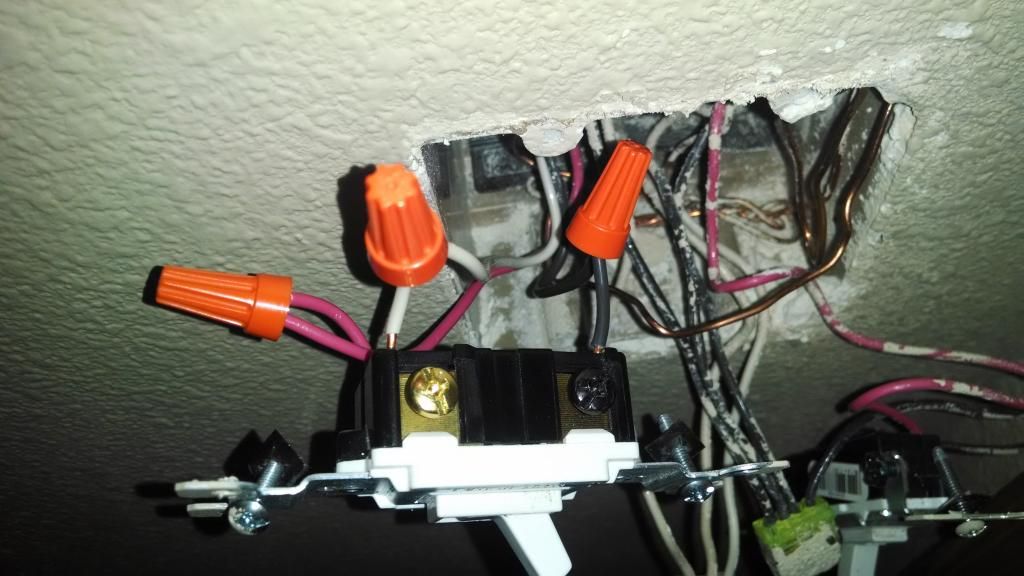

Here is the top of the stairs, where I would leave a standard 3 way switch:
This is where I am getting confused, there are wires connecting this switch that appear to come from two different romax.

One of the switches has to be connected to 2 different Romexes because one of them is the feed from the breaker box. If you disconnect the line that comes from the breaker box, it will be hot all the time. That's how you'll know which one it is. Without that line, nothing will be hot.

I looked at the diagram wrong. You do not need a neutral but based on the instructions you need a companion switch not just any 3-way but one for use with that occupancy switch.. Do you have thatone in the left hand box?

I didnt buy a "companion" switch, but if necessary I would just return this Legrand switch and go with Lutron, because that switch appears to allow me to modify the standard 3 way, correct?
Lutron install diagram:
Would the Lutron set up work for me?
