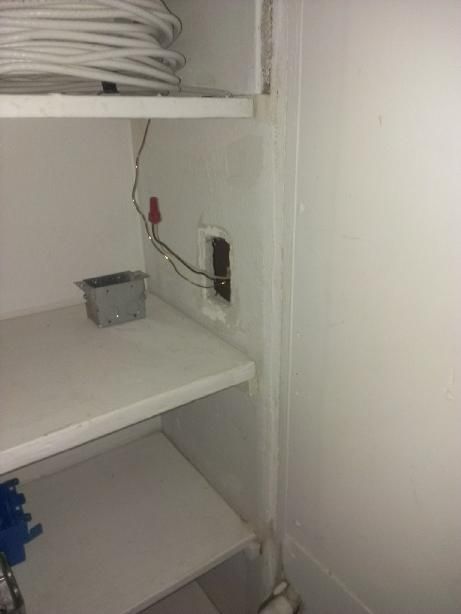

So I opened up the switch plate cover to the closet light switch, thinking perhaps I can add a receptacle there. I think I just opened a can of worms.
First, the cover plate will not come off, turned out it was packed full of adhesive caulk...after prying it out, the switch box itself was "caulked" to the wall board, instead of nailed or screwed to framing. There is a piece of 12-2 NM cable that comes in through the KO hole (no connector used). I then removed the switch box. As you can see, this is inside the closet.

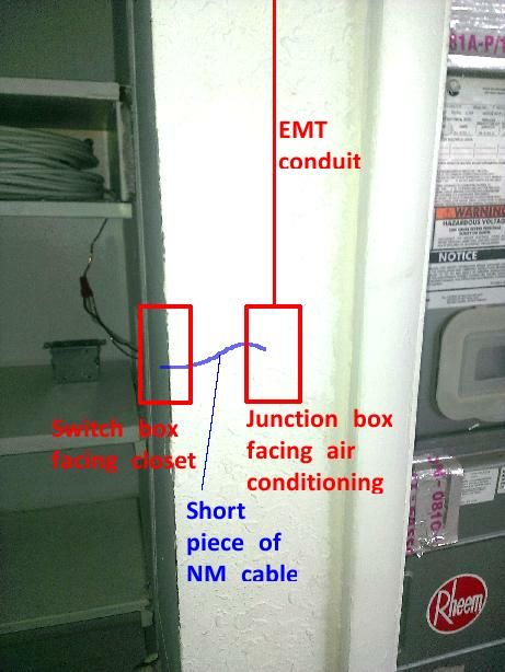

If I peak into the hole, I can see the back side of another metal box where the NM cable comes from, what the? So I looked on the other side of the wall, well, that happens to be the tiny closet where the central AC unit is.

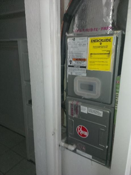

If I peek behind the air handler unit, I can see a blank cover plate on the wall. Can't get to it, but I can see it. The air handler is in the way. So QUESTION #1, this junction box can be seen, but can't be reached, not without removing the air handler first, I have a problem.
So I am guessing, at one point in time, the switch to the closet light is on the outside of the wall. Then they added the central AC system, so they closed off that switch box, and put in a new switch box inside the closet, on the other side of that wall. So this is what I have.

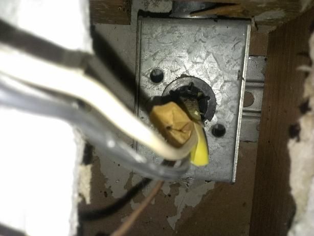

Why they didn't just free up that switch box, turn it around, and add an extension ring to it, I don't know. So here is a close up picture of the back of the old switch box, note that there is an EMT conduit connected to it up top.
If I can access that box from the AC side, I would redo the connection, but I can't. So here is my plan.
I would like to mount a 4" square metal box to the back of the old switch box WITHOUT any conduit or tubing in between (because I can't access the front side of that box to make the connection). I will enlarge the hole in the wall, to accommodate a square box, such that the 3/4" KO hole will align directly onto the plastic NM connector of the old switch box. Then I will tap and drill two 10-24 holes, and use 10-24 machine screws to connect the two boxes back to back. If the new box is recessed into the wall cavity, I will use an extension ring or mud ring to get it to sit flush. Like this:

I think your plan of attack will work, although it still leaves the "accessibility" of the other box in question. Should anything go wrong with the conduit wiring and the NM wiring in that box, you can't access it. However, technically it is not hidden in the wall and is accessible with the removal of the air handler. It is a switch loop and there is no neutral, as you have stated. Will you be using it as a switch or a receptacle/switch? Having conduit you could possibly run a neutral from its origin into and through the box and out your new box (before you attach the new one). If so, you can have the best of both worlds.

Do we really know it is just a switch loop in the box facing the airhandler? I don't think so, there could be a neutral in that box, but we really don't know.

How many conductors are coming out the back of that box? It's hard to tell from the pics ,but looks like 4 to me,where is this blocking you mentioned? Is the plate on the box metal or plastic,I would try an cut around the box and spin it you should be able to loosen the lock nut by working the box around.

It's a piece of 12-2 NM cable coming out of the back of the box.
There is wood stud to the right of the box and wood middle plate right above the box, if you look at the last picture, you can see the wood plate notched for the conduit.
