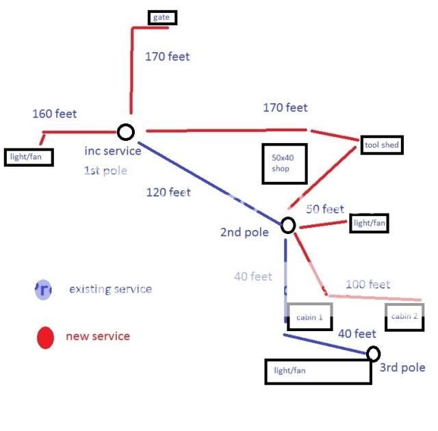

This is for a rural property, no permits or inspections are required. I just bought a used trencher and would like to install electrical service between the poles and buildings myself. The actual "inside the box work" would be left to an electrician. We're not opposed to having our service provider upgrade our incoming power.
Want to go direct burial, 18" down, leaving several feet of slack at each end.
I have an account with a local electrical supplier as I play a low voltage contractor during the week
What size wire would I need to each?

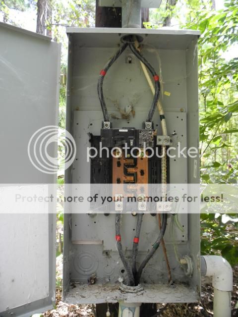

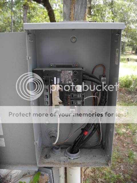

Blue is the existing service (toned pathway), red is what I need added. Not opposed to re-running a larger feed between pole 1 and pole 2. Here's what we want to power up.
Gate: sliding gate, lights, and once a year, Christmas lights
Tool Shed: lights, fan, feed to future 50x40 shop.
Shop: maybe some light wood working, sanders, lighting, large fans, ac unit for an enclosed storage area (paper goods, etc.)
Light/fan (2): two lights and one fan
Cabin 1: lights, fridge, freezer, small ac unit, fan
Cabin 2: 220 ac unit, fridge, freezer, washer/dryer, water heater, stove, septic unit, lights, fans, 1000w computers (2),
3rd pole (concrete patio): three ceiling fans, lights

Pole 1
Pole 2
Pole 3

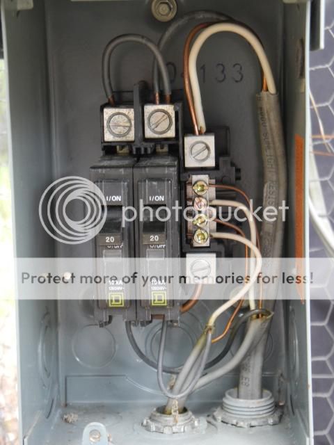

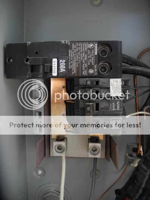

You have several issues with the existing setup.
The neutral is not identified and the use of a plumbing 90 is incorrect.
In this one:
You have a white on the feed through lug that should be re-identified as a hot. It also looks like there is no neutral to whatever that cable feeds. The wire may also be too small for the lugs.
In this one:
The lugs should only have one conductor in them. The neutral and grounds need to be separated and a ground bar installed. Also the neutral in the cable is undersized since both breaker are now on the same leg.
The smallest service allowed to a dwelling by the NEC is a 100 amps. The feeder to the shop is based on the expected loads.

Why are two feeds marked for the tool shed on your diagram?
Old 02-02-15, 07:52 AM
1
Join Date: Oct 2011
Location: usa
Posts: 171
Aww crap, messed up that drawing.
The 2nd red line to the shed is 120' and should have been a different color just for reference.
