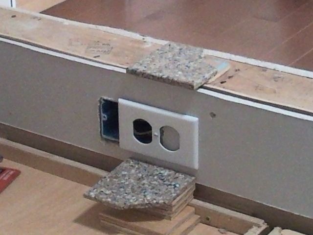

Kitchen countertop-receptacle height
One wall of my "U" shaped kitchen has a hip wall at 41" The center of this wall will have the sink. Due to floor being not entirely level elsewhere, with the high spot being on other wall, I had to raise cabinets about 1/2" along this wall so they are are about 35". The counter top will be 1 1/4" thick making the height of counter-top at 36 1/4" the back-splash will go on the wall and completely cover it, than a kitchen bar counter will sit on the hip wall overhanging the back-splash slightly. So with the top of that wall being horizontal 1 1/2 stud, that means the highest the horizontally mounted receptacle can be is about 37"-only about 3/4" above counter-top. Is this acceptable? I see this kind of setup all the time with bar height counters, but never paid attention if receptacles were in the back-splash. By code, there would have to be receptacles so I assume that is where they have to go. Just got measured for counters and suddenly I got paranoid about it so thought I better ask.

The measure/template person does not care about exact placement of outlets, only how many, where, and if it will work with given height. The cutouts in splash will be made by installers on site.
That said, I would get bottom edge of box a little higher. I would shave (mortise) the underside of 2 x 4 wall cap (in box locations only) enough to where receptacle will be centered in splash.
The 3cm is very heavy, but the mortising will not effect the wall's ability to hold the weight.

If your countertop is an 1-1/4" thick can you even fit a receptacle in there ?
What is the distance between the red lines ? You'd take that and subtract 1-1/4" to see how much room is left.
The centering is going to be critical.

I just ran the numbers. I can post a drawing if you like later tomorrow.
Receptacle will fit with mortise as I described, but it needs to be deep, about 1" and won't leave much clearance at top or bottom.
After seeing PJ's concern, I would place counter on hold. Nothing will change except splash height behind sink.
Wall needs to be raised and boxes raised. This is a pain, but when you're paying for 3CM, you want it to be right.

I agree with Brian, the boxes should be higher that what you originally pictured.

As long as the covers will fit you are fine code-wise. I do think they will look odd. I like the idea of cutting some of the bottom of the 2x away to allow the box to be raised.
I would make sure to use adjustable depth boxes to cover the backsplash depth.

thanks all. I guess you all missed the adjustable depth boxes that are in the photo-the blue line practically hits them in PJMax post? so in PJmax altered photo there is 3/4" from blue line to bottom of the boxes (assuming blue line is top of counter), and about 1 1/8 from top of boxes to top of wall. So I only would need to take about 1/4" out of bottom of stud to center box.

well the main thing is code and seem OK there according to pcboss, and I know he is in my state. If I move them, I think I would use my oscillating saw for this. Shouldn't take too long. I was measured Friday and they said 7-10 days so I don't think I have to put on hold. Silestone comes in 3/4" and 1 1/4" (3cm). I know they told me it was going to be 3/4" (which I thought was strange at the time) and if it were, I would be fine with boxes as they are. or maybe they said 3 cm and I heard 3 quarters?
well reviewed with wife and she said leave it as is if it passes code-but I may center it as you guys suggested cause I agree it would look better.

some mock ups of my counter. ends up with 1 1/2" above box and 1/2" below. So I would be taking out 1/2" if I do it.

The mock-ups illustrated the situation perfectly. It would be your choice to move the receptacles.
In my opinion...... they are fine where they are.

I don't mind the position so much, but you're walking a fine line.
The counter may need to be leveled. Ideally, the cabinets are perfectly level and minimal shims are required.
