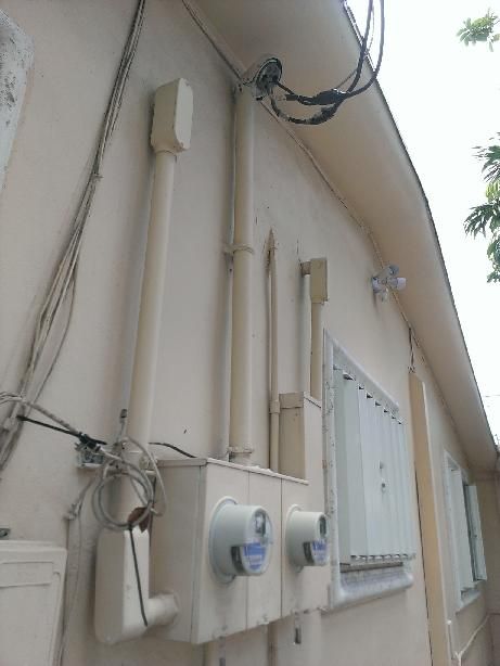

OK, I have more new information about this. Let me load up some pictures and explain...THE PLOT THICKENS.

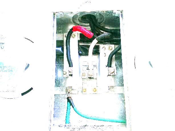

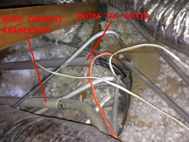

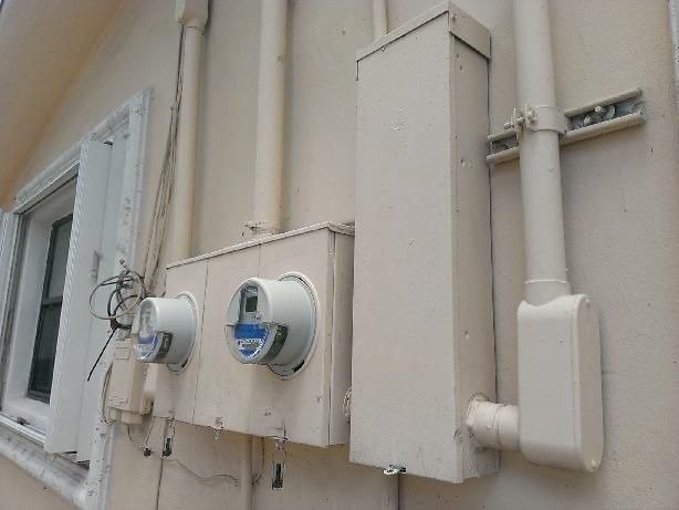

Now, I dug around a bit more in the attic, and I found something!
I didn't see this before, because the air conditioning duct was hiding it. Parallel to the 2" PVC conduit that feeds the panel, is another large pipe, looks 1.5" EMT or rigid conduit, not sure which but it is metal. This pipe is abandoned. It was just laying there, not connected to anything. See the picture below. That pipe had an elbow.
So my thinking is, this was the ORIGINAL conduit that fed this panel. It was removed and abandoned for some reason. That original metal conduit served as ground to the meter box previously. There are also three conductors inside the abandoned conduit, they are not live, I tested them.

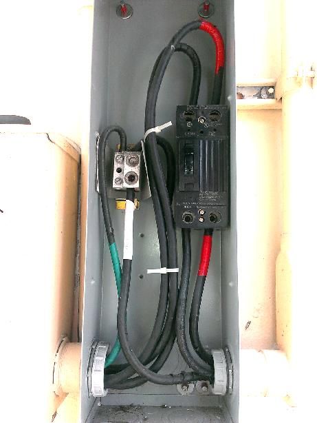

Now I went outside and looked at the meter. This is a two unit duplex with two meters and two electrical panels. The service comes in to the weatherhead mounted to the outside wall.
I opened up the cover of the box in the middle.
Now from there it does go to a disconnect and up the wall into the attic.
So I could disconnect the service to the panel.
This look original work, there are multiple layers of paint over these pipes. These pipes are all metal.
So my thinking is, some time back, they removed the old metal conduit inside the attic and switched to a PVC conduit. Why? I have no clue. What I think I need to do next is to crawl all the way back to find the exact spot where they switched from the metal conduit to PVC and see how that's done. May be it's also an "open ended" gap there as well.
This is a nightmare.

The metallic conduit in the attic is either rigid or intermediate conduit, definitely not EMT.
The box between the meters should have been sealed by the electric utility. Having it "accessible" makes it fairly easy to steal electricity.
The conduit coming out of the right side of the single circuit breaker panel looks to be PVC. Can you tell us what nominal size that conduit is and what the wire sizes are?
What is the ampere rating on that circuit breaker?
Can you post some pictures of the "main" panel inside with the inner cover removed?
Do you see any sign of a "ground rod" and/or conductor in the earth immediately below the meters?
Agree, it should be sealed. What confuses me, because of the lack of light, is why the service entrance wiring from the conduit service riser isn't terminated in the center section. Generally power is bussed from the center section to the line side of each meter socket.
I'm pretty sure it IS wired to the center, the shadows where the conductors are looped back make it difficult to see.

Maybe so, Furd, you might be right. Normally the service entrance conductors from the conduit riser would go straight down into the lugs, it's just easier to do it that way. A loop in the conductors isn't a code violation, but a bit unusual.

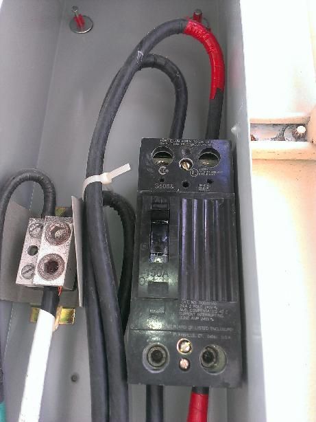

Casual Joe here is a better picture showing the loop, but it's hard to take a picture in bright day light and the box is a bit dark.

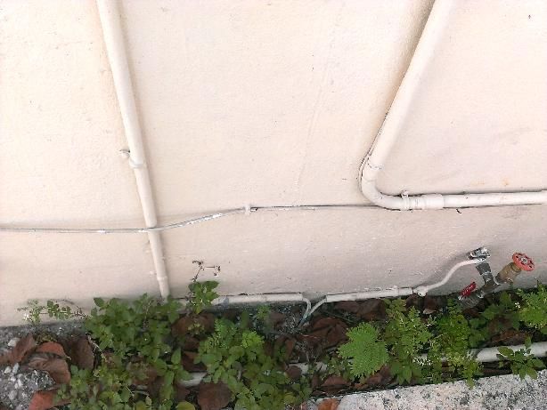

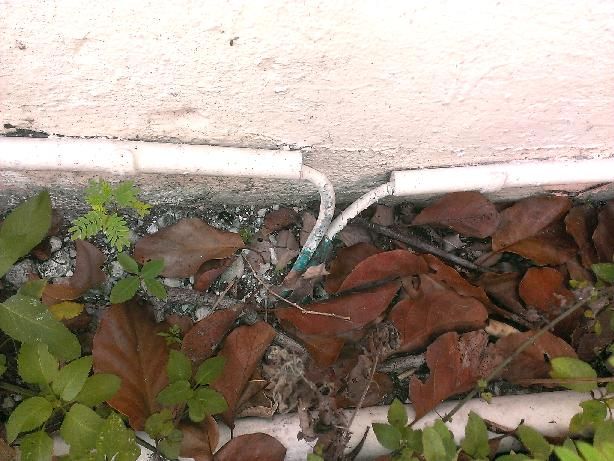

Furd, here are some additional information.
You are right, the pipes outside are indeed PVC. The marking says CANTEX 1-1/2". It does have several layers of paint, so I think this means it has been there a while. I just could not believe this wasn't permitted work, it is outside where everyone can see, and requires the power company to come connect and disconnect which that alone requires a permit.

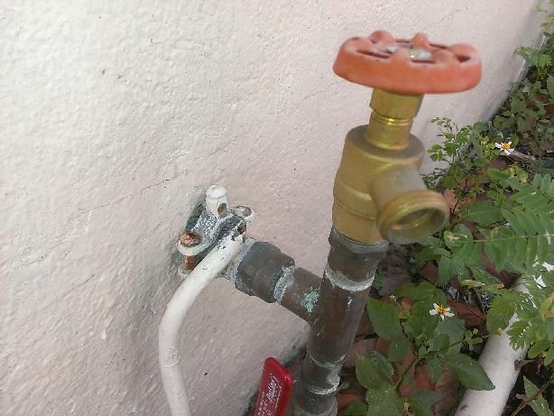

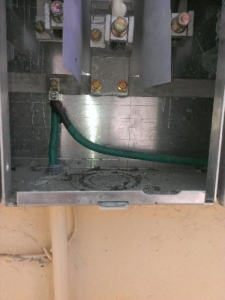

As for the grounding, here is a picture of the lower part of the box, there is a conduit that comes out from the bottom.
This conduit then runs along the wall, then a green conductor goes into the ground, and comes back up and runs over to the water shutoff valve, and attached to a clamp there.
Here is again a picture of the PVC conduit right above the panel. You can see the PVC conduit and the abandoned metal conduit runs deep into the attic.

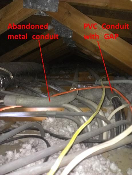

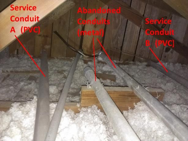

So today I went up to the attic again, to trace these two lines, and I got all the way to where the two services entered the building, inside the attic.
There are a few more abandoned metal conduits, I have no idea why. But the two PVC conduits run to their respective panels, I didn't see any "GAP" in the conduit, other than that one I showed in post #1.
So I need to feed a green conductor along side the existing three conductors?

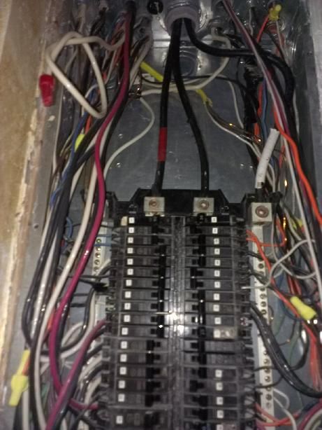

Here is a picture of the panel, the wiring looks like spagetti inside.
Your picture in post #20 clears up a lot, but raises another question. In that picture it appears that there are only two conductors coming into the 2-gang meter socket from the conduit riser. Is that right or are there actually 3 conductors?
I see many conduits in the attic that appear to be branch circuits. Is there, or has there ever been, a requirement in your area for all branch circuits to be in conduit? I just find it highly unusual for anyone to use conduits for branch circuits if the use of NM cable is allowed.

Three conductors, it's just the angle. Here is an earlier picture with the brightness adjusted.
I have owned about a dozen homes in South Florida and they were all with EMT conduits and metal boxes. Now the homes I bought tend to be older homes built in the 60s, 70s and I really don't see any NM cables unless the home has been remodeled at a later time. I kind of like it as it is easier in many cases to run new conductors and I can ground the devices to the metal boxes as long as they didn't break the continuity...which goes back to the question which is I need to run a ground wire to the meter box right?
There are those abandoned metal conduits. That one is almost 60' long and there are three abandoned conductors in them I think #2 or #4. I wonder if I can pull them out and scrap them for a pitcher of beer LOL.

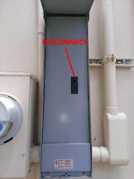

You need to show a picture of the circuit breaker (disconnect) next the the meter with the inner cover removed. Based upon the green wire in the center box your neutral IS bonded to ground (earth) and the green wire going off to the right suggests that a grounding conductor does pass through the meter enclosure to the circuit breaker enclosure. By rights, that grounding conductor should pass through the circuit breaker enclosure (also bonded to the enclosure) and continue through the PVC conduit to the main circuit breaker panel where it would be connected to a bonded equipment grounding bus. Also, there should be yet another green wire going to the left to the other meter and beyond. Further, I do believe that you need a multi-tap lug where the two green wires are linked.
Please also show the main circuit breaker panel with the inner cover removed as I suspect there are discrepancies in the way it is wired as well.

Tolyn Ironhand, if I need to run a ground conductor from the disconnect to the panel it might be tough with such a long run and I guess I need a big green conductor like a #4?

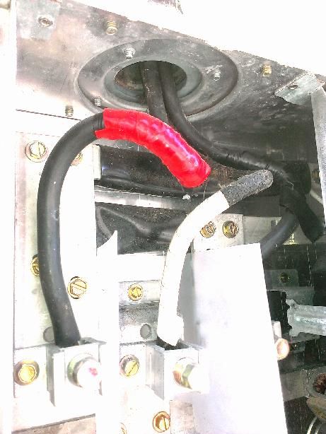

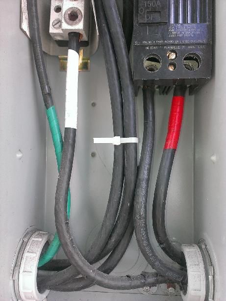

Furd here are some more pictures. I didn't open the meter box because that one has a lock on it.
But here is what the disconnect box look like without the cover:
Close up:
On the panel side, with the cover removed...it looks a bit messy because once the cover is off I started to pull and tuck individual conductors to see what's what. But you should be able to see where the three conductors go.

You need a #6 copper or #4 aluminum ground. The ground wire in not required to be installed in the pipe. You could run it alone on the outside. If it was me, I would use #6 solid for a ground.

If those are 1/0 conductors or smaller in an 1-1/2 inch PVC conduit it should be no problem running a #6 equipment grounding conductor through the conduit.
You would also need to add a bonded equipment grounding bus to the circuit breaker panel, remove any bonding screws or straps from the neutral bus(es) and move any equipment grounding conductors from the neutral bus(es) to the new equipment grounding bus.
