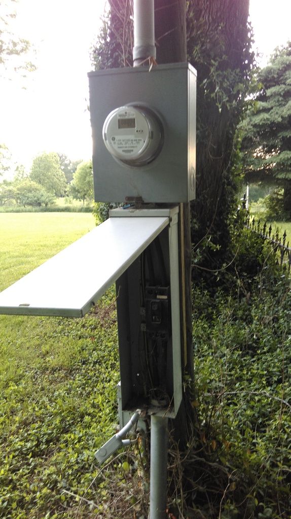

Well, I bought a 100+ year old fixer-upper. I knew it was going to be a complete rewire coming in. I was told that my wife's uncle was a retired electrician... turns out he's retired, and for 2 years in the 60's he did some electrical work. So I'm doing the best I can and I think doing a good job, but I've run into some major issues on the service.
I have 200A that goes to a pole in the yard. It has a disconnect on the pole and it's buried to the house (there's a circuit off the pole going to the lights at the end of the driveway, but lets ignore that for now, unless it's found to be relevant later). The aluminum wire enters the house into a box and ends. It's spliced using a split nut to the wires that feed a 100A (I think, going off memory here) panel in the garage, that has a 60A(I think) sub panel going to the pole barn.
Immediately after that splice, is a spliced extension into the main panel for the house. That was about 3 feet, I replaced the old panel and extended it about 20 feet away as it was directly above the sump pump and I didn't like standing in/near water while working on electric.
There was another splice in the wires feeding the main panel that run upstairs to a 60A sub panel. It was old cloth wiring, and I did not reconnect it when I moved and installed the new panel this weekend. However, I would like to have it running the power upstairs (3 bedrooms, 1 bath) as a true sub panel off the main.
I know that sounds all sorts of messed up, and I would obviously like to correct it. Here's a quick sketch to help clear some of that up. I appreciate any help you can provide, even if it's "call a real electrician".

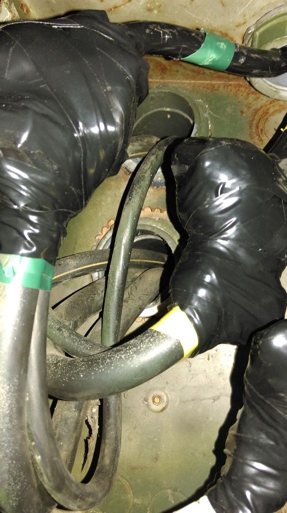

Join Date: May 2015
Posts: 15
Received 0 Upvotes

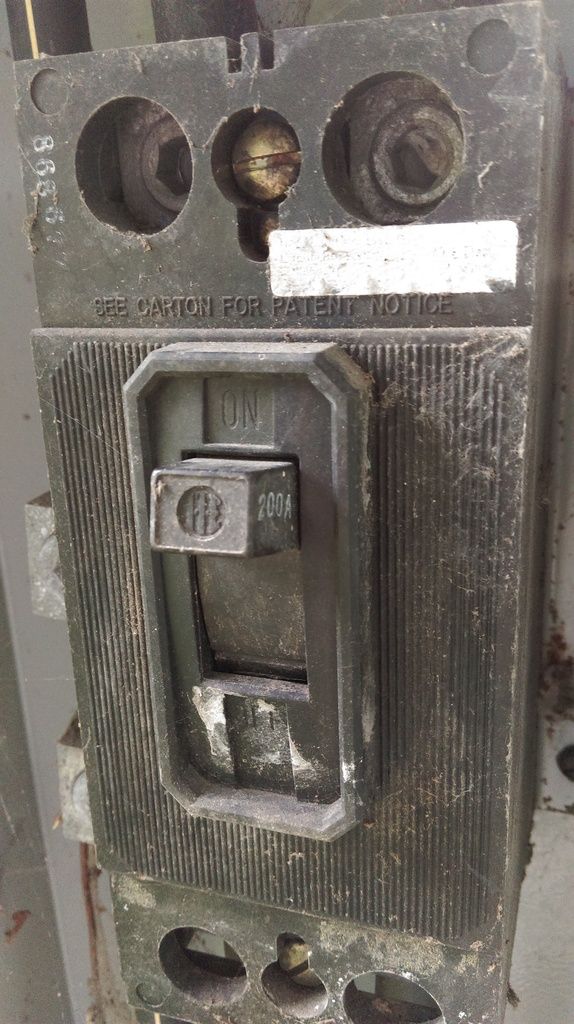

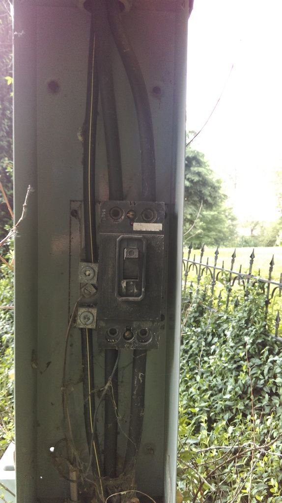

I think what I labeled as a disconnect is actually a 200A breaker. I'll take a few pics of it when I get home. I'll also try to get a better diagram that includes lengths/material/gauges.

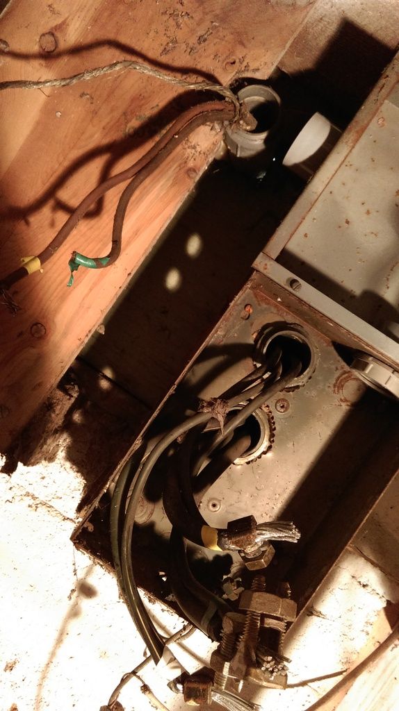

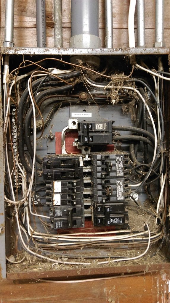

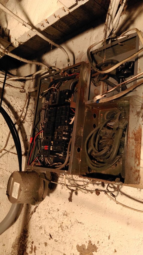

Here's a couple of pics of inside the house:
Before I started. The panel on the left is for the house. The lower right box is where the main feed comes in and is spliced to the feed for the garage panel and goes up to the main on the house panel which routes through the top right box and inside the panel was spliced to the cloth wiring that runs upstairs to the 60A. (I was unaware of that cloth covered wire, outside of the house it is spliced into some THHN).
Bottom pic is new panel, which I extended 18' from where the main enters, I know that's 3/0 copper in 2" Sched 80 conduit.
In looking at your main panel.....actually sub-panel..... you're going to need to separate your grounds off the neutral bar and install a dedicated ground block. I don't see four wires coming into your panel either....... no ground wire.
The ground should also come from the main...... the ground goes to a grounding bar..... not the neutral bar. The whites and grounds are kept separated.

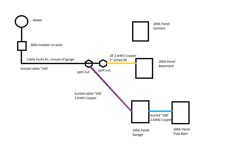

So here's a quick diagram, I used different colors to show different pieces of wire, since the first one goes through 2 split nuts.
Pole and 200A breaker:
Where it comes into the house. The large cables on the bottom are the mains from outside (I can't tell what gauge because they were painted long before I got here), the smaller green ones go out to the garage. The black above are the ones I just ran to the new panel. Each bundle has 2 split nuts wrapped in rubber tape and then vinyl.

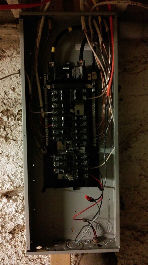

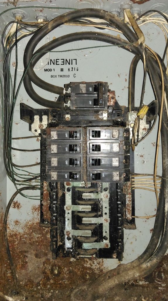

Panel upstairs, this will turn into a sub panel off of the basement. I realize this is wired incorrectly, but it's not connected.

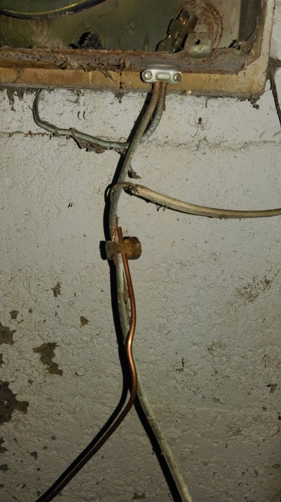

grounds as they come in the house
garage panel (obviously needs cleaned)
pole barn panel (had a mouse nest, will be replaced)

Referring to the sketch in post #6 I see at least one major problem. #2 copper wire is rated at either 95 or 115 ampere capacity depending on the insulation used. This drawing shows a 200 ampere circuit breaker with #2 taps along the way. These taps do not meet the rules for taps as defined in the NEC. This means that these #2 conductors do not have proper overload or short circuit protection. To be in co0mpliance and for safety any conductor downstream of the 200 ampere CB and before an additional circuit breaker MUST be at least 3/0 copper or 4/0 aluminum.
IF the existing aluminum from the 200 ampere circuit breaker is 4/0 size it is acceptable, if it is less than 4/0 it is undersized to both the load and the protection.
The two #2 taps off of the aluminum are simply not allowable. You need a circuit breakers or fuses of no no larger than either 100 or 125 amperes (depending on insulation type) where these split bolt connectors are located for EACH feeder.
The #2 feeder going to the garage panel would have a 3% voltage drop from the aluminum to the garage assuming a total load of 100 amperes including the pole barn. That is generally acceptable IF the supply voltage is within the 10% +/- variation from 240 volts. If the supply voltage at the point of connection (the split bolt now) is on the low side then this may be excessive voltage drop depending on usage in the garage and pole barn. Similarly, the additional 100 feet of #2 copper would mean less than 1% voltage from from the garage to the pole barn assuming a load at the pole barn of 50 amperes. All these voltage drops are, of course, dependent upon the actual amperage loads at the respective panels. If the existing aluminum wiring is less than 4/0 in size the voltage drops will be higher.

Thanks gents, I really do appreciate your patience and knowledge.
First of all, I mislabeled my diagram, the copper wire going to the 200A panel in the basement is in fact 3/0.
So if I am correct, I would install a box with a 200A main breaker and connect the feed from the outside. In that box I would run a 200A circuit to the panel in the basement and a 100A to the garage. Which basically makes those two into subpanels, right? Could I also run the 100A panel upstairs off of that, or would it be best to make it a subpanel off of the basement?

First off, every panel downstream of the 200 ampere circuit breaker on the pole is a "sub-panel" and must have a four-wire feeder. If the aluminum wiring (you haven't stated if it is a direct burial cable or individual conductors in conduit) is only three conductors then it is wrong. However, it may be grandfathered under some specific instances. If those aluminum conductors, at least the "hot" conductors, are less than 4/0 in size then either the 200 ampere circuit breaker needs to be downsized or the aluminum conductors replaced.
Rather than use the panel you linked to I would prefer to see one that had a minimum of four spaces to accommodate two-2 pole circuit breakers and also has "feed through" lugs. One 100 ampere 2 pole circuit breaker would serve the garage and pole barn and the other would be a spare. The feed through lugs would connect to the 3/0 copper going to the house. It is unlikely you would find a panel with feed through lugs at a mega-mart homecenter but would need to go to an electrical supply house. It is also unlikely that you can find a panel that will accept a 200 ampere branch circuit breaker (for the house) at any price that you would be willing to pay.
The "100 ampere upstairs" panel MUST be supplied from the main house panel. This is because the NEC is very strict about having a single point where all electricity in a building may shut off. While there are some specific exceptions to this rule none of them apply in your situation.

That panel will certainly work but you don't need the main circuit breaker. All you need is a panel with main lugs, feed through lugs and the ability to hold at least one 2-pole 100 ampere circuit breaker for the garage/pole barn. It may be that you won't find one that accepts just a single 2-pole CB and will have to use one that will accept two, 2-pole CBs or a combination of one, 2-pole and two, single pole breakers. The added circuit breaker capacity is only for future use and may never be used.
OR, you can replace that #2 feeder going to the garage/pole barn with a 3/0 feeder and entirely do away with the feed through panel and CB. That, however, will be a mighty costly endeavor.
Here's a third possibility: Depending on the total load in the house and the total load in the garage/pole barn you might be able to move that #2 feeder to connect up in the house's main panel. That would mean that the aluminum from the 200 ampere CB at the distant pole would be spliced to the 3/0 coming into the house (in an approved manner, of course) and then have a 100 ampere CB connecting to the #2 feeder for the garage. This would be the simplest but whether or not it is feasible depends on the total loads. Since the total supply is only 200 amperes I think that this third option is the definitely doable.

Ok, so finally got a chance to look at the grounding situation... there's a bare ground from the meter going to... well nowhere. It looks like the cable company cut it to ground their splitter and didn't hook it back up. I will fix that.
The ground doesn't appear to go to the house. There's a rod outside of the house where the main service comes in and that goes into the house. All the runs between buildings are 3 wires only. On every panel on the property the neutrals and grounds are on the same bars.
Thoughts?
Thoughts?
#30
Join Date: Mar 2006
Posts: 16,321
Received 38 Upvotes
30 Posts
...there's a bare ground from the meter going to... well nowhere. It looks like the cable company cut it to ground their splitter and didn't hook it back up. I will fix that.
You need to talk with your inspector to see if he/she will allow this condition to exist after your changes.

If your inspector has approved a three-wire feed to the outbuildings, then you do not need to separate grounds and neutrals in those panels. In fact, you should have a bonding screw or wire that makes a connection between the neutral bar and the steel box or the ground bar to guarantee a solid connection between them.
This is the "old" way of doing an outbuilding as of about 10 years ago, but plenty of places still allow it.
