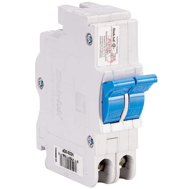

Nono, you have two circuits sharing a neutral.
Your breaker is technically two breakers but with the handles tied together. I'm assuming you're using a 2 pole breaker?
http://www.rona.ca/images/1614004_L.jpg
You used a 14/3 wire. Your red wire is one circuit attached to one breaker, your black wire is another circuit attached to the other breaker. Therefore you have two 15A circuits sharing the neutral.
