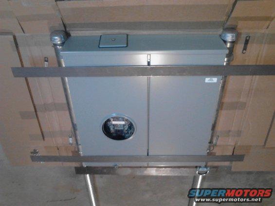

In the meantime, I did grab some pics of the setup I've prepared to install the power box.
May as well share 'em, since I took 'em already.
This is just roughly laid out for me to assemble on the next day I've got free'd up.
Top of the siemens outdoor power panel/meter box... showing capped ends of galv. posts.
Damn galv. posts aren't cheap these days. Bought a 21ft. and had it cut in half, instead of paying by the foot for 2x 10' posts. The wood across the bottom shows "ground level" to keep the meter high enough to satisfy code inspection.
Roughly how it will look from the ground up (if you were taking a picture from under the invisible earth).
And a picture of the inside of the power box...
Close up of the galv. posts and u-bolts that will hold the mounting straps in place. The post is approx. where it should sit installed.
And a final pic to show the rough location on the post of the top mounting strap. The other one you see at the bottom will face the opposite direction and be used to bolt the plug-in boxes (1x 30 amp & 2x 20 amp standard CGFI's) too, under the panel.
I also picked up c-type lock nuts and thick washers for the u-bolts. I'll drill my holes in the mounting straps and then paint them with a primer sealer, a few coats should do to keep those surfaces from getting rusty in the exposed weather, for a few years anyway.
I'm planning to assemble the whole thing on the garage floor and then pick it all up together with the hoist on the flatbed. Then I can drop it in the holes, center it up and pour 2 bags of quick-crete in each hole to secure it in the sandy ground. I had hoped to get a full 4ft. or more deep... but to keep the meter up high enough, I'll only be able to sink the posts 3'9" into the ground. Hope it's enough.
So... there it is. Wish me luck! :toothless

It all seems OK to me. An additional disconnect switch is not required beyond the breakers you have in the "main" part of the "meter/main" combo box.
We usually mount freestanding exterior boxes like that on a stand using two 4x6 treated timbers with doubled up 3/4" outdoor plywood lagged in and with stainless fasteners (POCO requirement) attaching the panel to the plywood & posts. Commercial is usually fabricated with unistrut on a concrete pad or wall. Your galv pipe option seems like it would be acceptable along those lines as long as you use all heavy weather resistant hardware. Our frost line is 3'6" so the depth would be ok, but that is based on your local area.

My concern over the disc. switch was mainly for my personal safety if I had to get into the box and swap out breakers or add new lines in the future (like, if the dream shop ever happens). Without one... I assume I'll have to call the PUD and have the whole thing shut off to do that type of future upgrade/add-on work?
The metal straps I'll be using to mount the box between the galv. poles will need to be pre-drilled and then painted with rust inhibitor prior to mounting.

Unistrut is pretty much the standard in the electrical industry for mounting large panels.
You can put the 20A and 30A breakers for the RV receptacles in the lower portion of the panel without the need for an additional panel.

well... I broke down and went after the unistrut this afternoon. Was pretty beat from some garden hose bib relocating and re-enforcing I did yesterday, but I got the unistrut in place and mounted up on the posts. Just need to get some proper nuts and bolts to secure the panel now and I should be dropping it in the ground.
I see the panel I picked up is setup for 8 breakers... so I was hoping I would be able to do that with the lower part of the panel. Now I'm just wondering if I should switch out the 200a main breaker that's on the lower 1/2 for a 100a, to divide up for the RV connections.
I suppose I could just use the 200... as I'll still only be drawing the 30 & 2x 20's.
Either way... I'll have to get it all figured out before I call out the PUD to hook it all up.
Greatly appreciate the help in here guys!
Just leave the 200A main breaker as-is. The panel is designed to split the 400A service into two 200A feeds. One goes to the top bank, in which you can set a single type QNR breaker (150A, 175A, or 200A) to feed your future workshop. The other goes to the bottom bank where you can set up to 8 type QP or QT breakers for use in this location and use the feed-through lugs at the bottom of the bus bars to extend feed another 200A panel either here or at another location.
