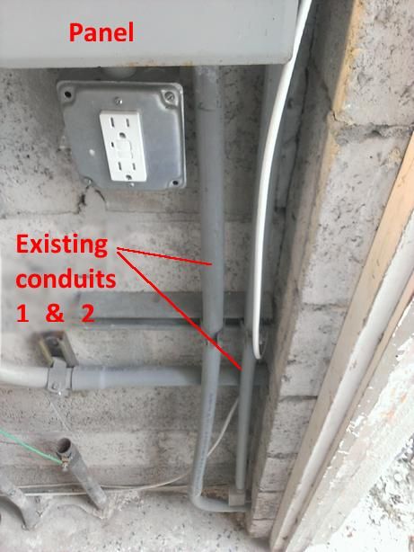

EXISTING CONDITIONS:
From the utility room I have a main panel and it has two PVC conduits that runs down, then exit the 8" concrete block wall, the 3/4" conduit runs about 35' underground to a shed where the washing machine and dryer are. This conduit right now has six individual conductors in it, four #10 and two #12 stranded conductors for the dryer and washer. The 1/2" PVC conduit is abandoned, has nothing in it.

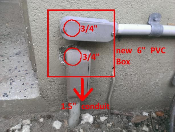

Here are some pictures to make it easier to visualize.
I would like to add a small 1000W gallon water heater in the shed for the washer which would need another 15A circuit. To do that all I really should need is another #12 conductor, I can share the neutral with the washer by putting the two breakers on opposite legs. However, the 3/4" seems too congested to even try.
On top of that, I have in my garage, sitting and collecting dust, five 10' long 1.5" PVC electric conduits. Also collecting dust a coil of NM 6-3 about 60' long. and also about half a dozen of 60A breakers.
So I am thinking, why not dig a new trench, and run a new 1.5" conduit to the shed? I already have the conduits, I already have the breakers, I already have the wires. Run the #6 to the shed and put in a 60A subpanel, and from there, washer, dryer, water heater.
The issue I see is, I don't have the room (as you can see from the picture), to run a 1.5" conduit from the panel through the concrete wall, the wall is very close to the door, and I have other pipes in the way. So I am thinking to reuse the existing 3/4" and 1/2" as pictured above.
Basically, it means on the outside of the wall, I would like a weatherproof (most likely PVC) box, that I would mount onto the wall where the two pipes currently exit. The two existing PVC conduits would tie in on the back side, then from there, I would connect to the 1.5" PVC pipe at the bottom then run underground for 35'. The only thing in the 1.5" conduit is the 6-3 NM cable. But in the future, I can add more wiring if necessary. Does that sound reasonable? Something like this?
I can't find any weatherproof junction box that has a 1.5" KO at the bottom, and two 3/4" KO holes on the back. Does this mean I will need to get a deep box and drill my own KO holes? Or is there a better way?

The 3/4" conduit you have is big enough to contain (3) #6 THHN (black,red,white) + (1) #10 THHN (green) conductor -- enough for up to a 70A subpanel in the shed. If you use #8 THHN, up to 50A. The shed should already have a subpanel as code allows for only one feed per building, and the shed already has two.
It should be a simple job of adding a panel on the shed side, and using the old wires to pull through new wires. A ground rod will need to be added at the shed and bonded to the ground bar with #6 copper.
The NM cannot be used underground.

I think it's fair to call this part of the house. Meaning you can run as many circuits as you want to this area from the main panel without a subpanel being required. If it is more convenient to do so, you could install a panel here. To address the immediate need with the least cost, reusing the abandoned 1/2" conduit with #14 THHN in black, white, green would be adequate for the 1000W heater.
