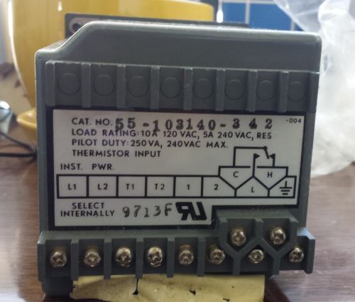

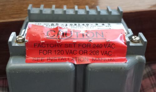

Hi! I have recently purchased an old Fenwal Model 551 Temperature controller. It has a sticker on it saying it can be set for 240, 208, and 120 VAC. I can't find the installation manual online and i don't feel like breaking it by guessing. Could use some help determining what each contact is for. I am from Canada Ontario so 120v input is what i am looking to select.
The only thing i could find is a feature info .pdf for it: http://mediaserver.voxtechnologies.c...6277544001.pdf
I am assuming that the C L H is for cooling load and heat? and maybe the 1 and 2 for the termocouple.
Thank you for your time!

Welcome to the forums.
L1 and L2 are power in.
T1 and T2 are for the remote temperature sensor.
1 and 2 are ??
C = common
L = low (N/O)
H = high (N/C)
As far as converting to a different operating voltage.... open it up and it should be easy to locate since it's sold as "field changeable".

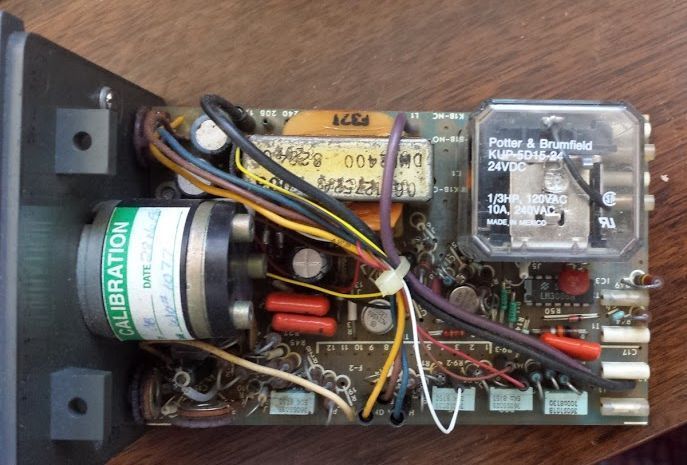

Thanks a ton! that explains a lot and taking a look inside, 1 and 2 are not connected to anything anyway.
looking at the module inside, i'm assuming that it's a 240VAC that i'm set for?
KUP-5D15-24 TE CONNECTIVITY / POTTER & BRUMFIELD | Power - General Purpose Relays | Newark element14 Canada

No...it's not set to 240v. It looks to be set at 120v.
The black wire connects to the proper voltage pin.
