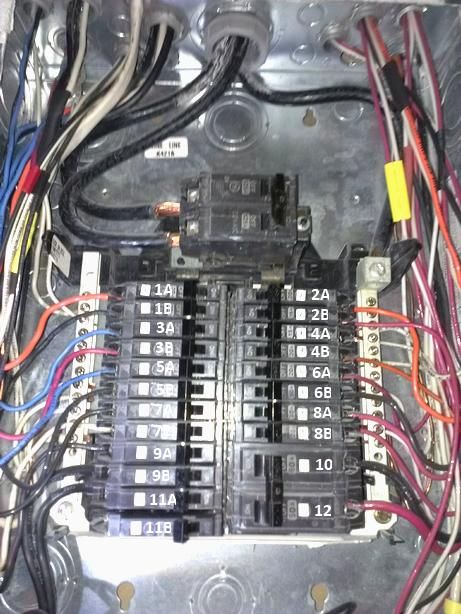

This is my panel with the cover off.
I started to mark which circuit is out. There are about six circuits that were getting no power at the panel. So that has nothing to do with individual devices or fixtures.
I flipped the main breakers off and on. No difference.
I flipped ALL individual breakers off then on. No difference either.
I was standing in the hallway where the panel is, and the hallway light was off, so I had to use a flashlight. The hallway light and the adjacent bathroom is on circuit 2A, a 15A circuit. So the first thing I tried to do is to get that light working so I don't have to hold a flashlight in my mouth.
I loosened the screw on the breaker for circuit 2A. Pulled out the #12 conductor, then I removed the 15A breaker for circuit 11B, which is available and unused. I connect the conductor for 2A to the 11B breaker, then inserted that breaker into the slot for 2A. Turned the breaker on. Turned hallway light on...works. Turned bathroom light and fan on...works. OK so may be that breaker went bad?
Now, I went to check on the other circuits that were not working, mysteriously they all came back. I turned on all the fixtures connected to these circuits, and flipped the corresponding breakers on and off a few times, no issue.
So the problem was a bad breaker for circuit 2A causing all this?
I then decided to remove breaker 2A again (which used to be the spare breaker in 11B). I took the original 2A breaker, connected the conductor to it, then insert back to slot 2A. Put the spare 11B back to where it was. Now I have restored everything back to the way it was when I came home.
Everything is working now. Yet I have this iffy feeling.
What could cause this?

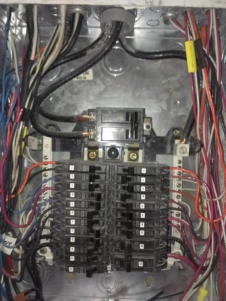

Every other row of breakers is the same..... so 1 and 2 are A, 3 and 4 are B, 5 and 6 are A, 7 and 8 are B, etc. You've lost the A leg of your service.
You also have an awful lot of bare copper exposed at the man breaker. Not easy to fix now as that wiring can only be killed by removing the meter or if you have an outside service disconnect.

I agree with PJ, you lost a leg coming in. It could be at the service connection, at the transformer or in the meter socket. Only the utility company can check those things.

I didn't realize that panel was maxed out with thin breakers. That means my original labeling was incorrect. The top four breakers are on the A leg. The next four are on the B leg.
You call it 1B but it's still on the A leg. You call it 2B which is still on the A leg. 6A is on the A leg as well as 6B would be also.

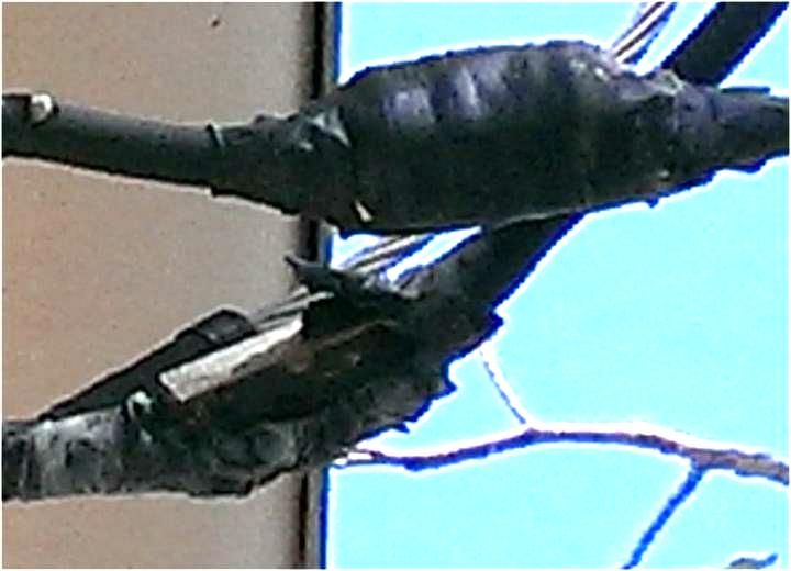

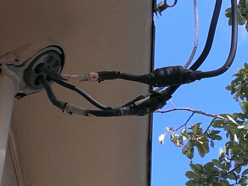

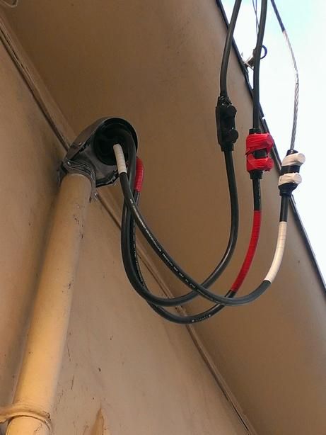

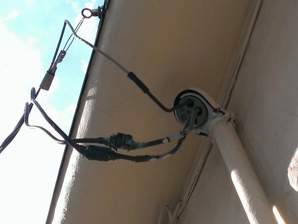

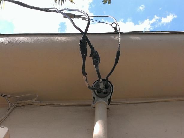

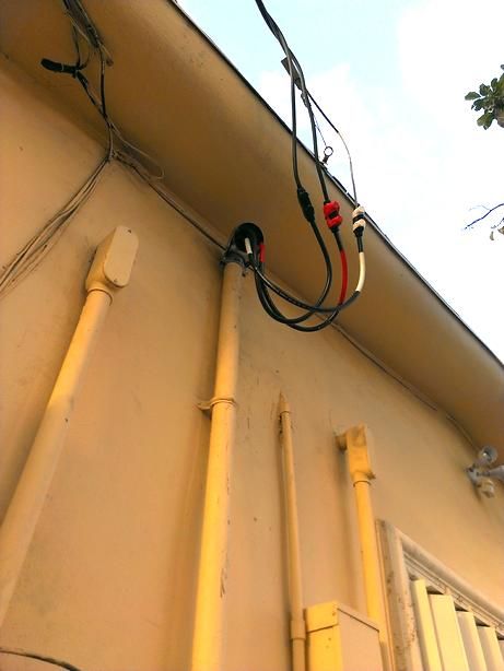

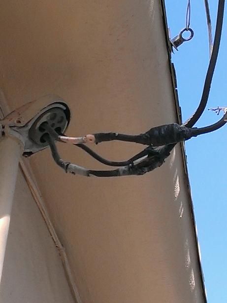

OK I think I have some answers.
The electrician came and looked at my service panel. He said everything seems OK except:
(1) There should be a ground conductor running from the meter into the house and a separated ground bar.

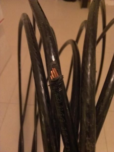

(2) The big conductor going into the main breaker they have cut off some strands to fit. He thinks I need a new set of main breaker for that conductor.
But none of these are causing the intermittent power issue I have been experiencing.
He went outside and pulled the meter can, then after a few minutes he said he found the issue.
The issue is the connection between the drop from Florida Power and Light and the conductors coming out of the weather head. He said for some reason, there are two connections made over the years. A "crimped connection" and a taped over split bolt connection. He is not sure why and who, but these connections are bad. Part of the metal is exposed, and the tape is falling apart. Furthermore he said my wiring from the connection to the meter is old cloth aluminum wires. From there into the house is new shiny copper, but from the meter through the weatherhead is old.
Here are a few pictures. I can't get a real close and sharp one as I don't want to get too close.
He said I need to replace the weatherhead, pull new wires from the meter and up, and remake the connections to the FPL lines, and pull a new ground conductor into the panel, add a ground bar, and redo the connection to the main breaker where the strands were cut to fit.
Does this sound reasonable?
Now I asked him if these connections were made by FPL shouldn't FPL redo these connections? These were this way when I bought the place. Isn't the poco responsible for everything up to the meter?
The electrician said no, actually the meter is the home owner's responsibility. So is the weatherhead. FPL is responsible for everything up to the actual connection itself. But since he is recommending replacing the weatherhead and old wires anyways, I should do everything then call FPL to make the new connections, they are not going to come out to "fix" the bad connections.
If there is a disconnect on the outside of the house, or the panel you showed us is not the main panel, then yes there should be a ground bar and the neutrals and grounds should be separated. However, if this is the main panel and there is no overcurrent device before this panel, it is fine as is.
If this is true then the wire is likely oversize. The main breaker should be able to take wires up to about #1. There will be a wire size rating on the breaker.
IMO it appears the weather head is fine. I would agree that replacing the wires from the poco drop to the meter and remaking the connections is a good idea. Yes, these are your responsibility. In my area it is the power company that makes the connections to the drop. I suspect your panel may have been bootlegged in. In my area the PoCo will come out to fix a bad connections.

Wish we had thought to ask you for pictures of the weather head. Had we seen them someone would have probably wrote bootleg. Look around at some of your neighbors connections and you will see what the poco connectors (AKA bugs) look like.
Example of poco connector:

The biggest problem with your old wiring is that since it was so short.... the crimps/bugs are in the bottom of the drip loop and are always wet which is why it corroded at those connections.
The weatherhead looks good but if the screws are all rusted like they appear to be.... it may require a replacement.
I guess if they delete the main breakers, then I wouldn't need to worry about it?

Finally had the electrician here today.
Replaced the weatherhead, ran new lines from the poco drop connection to the meter, put in a disconnect on the outside, added a ground wire from the meter to the panel on the inside, added a ground bar, and a few other minor things.
I got the afternoon window, so by the time he was done at around 6pm, its too late to call in an inspection, I would have to call them Monday. In the mean time the electrician reconnected to the poco drop, and told me to call for the inspection Monday, then FPL to come redo the connections. These are the new temp connections.
The electrician told me he personally preferred the temp connectors more so then the crimped style connections the poco uses.
We ran into a glitch along the way. As he fed a new ground conductor from the meter box to the panel on the inside, he was having trouble getting a fish tape through. So he pulled out a bit of the existing conductors. Then he showed me that one of the three big connectors has exposed copper. He said the damage cannot be repaired.
The conductors are size AWG 1/0. The electrician said I don't need wires this big for 125A so he would just replace all three conductors, and at 50' each the additional parts and labor would be $500. He said the other choice is to put in a junction box in the attic and that would be at least $500 in labor and I still have to buy shorter conductors. So I authorized the work. So there is no way to repair the damaged insulation? There isn't some commercial grade heat shrink tubing that could be used?
So now I have three 50' coils of AWG 1/0 conductors. Will it buy me a few beers if I sell the copper?

$500 for 150' of #2 copper and labor to install sounds a but steep to me, but labor rates vary. I would have taped up the nick with some quality tape and called it good.

Tolyn, I didn't have a lot of choices it was in the middle of the job and he said it can't continue or even re-energize anything unless that was done.
I asked him if taping it up and putting something like marine grade heat shrink tubing around that nick would be OK, he said no way not for conductors this size.
Next I asked him what if we use the conduit body to do a splice? The wires are a straight shot through the attic, then into the conduit body, and down. From the conduit body to the meter is about 4', and that nick is less than 4' in. If he does one splice inside the conduit body with a split bolt or the temp connector he used to connect to the drop, that may work. He said that conduit body (or even a larger one won't accommodate a splice).
I then asked him why I had to replace all three. Why not just replace 50' of the bad conductors. He said because my conductors are oversized. If I replace one, he would have to get 1/0, and that's not necessary. To get the correct size it would be a mix and match and that's not good.
Oh well so now I have three giant coils of copper.

Why did they put electrical tape around the splice connectors?
